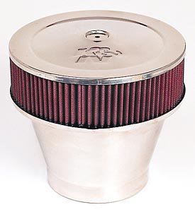

Velocity stacks can be 2 things... you see air cleaners on domestics, that extend into the air to grab more air with a filter on top or you have something like the Hilborn fuel injection stacks, they dont have a filter on any of the 8 "tubes", but they still extend up in the air to grab cooler air then what is down by the motor.
Here is the "air cleaner/intake" version.
