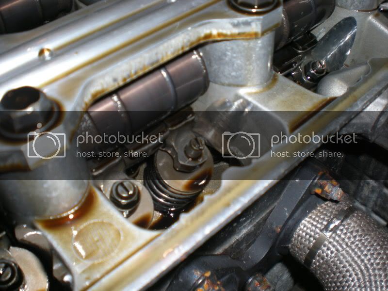

What is wrong in this picture?

    looks like 1 valve spring is tightened down more than the others.. other than that i dont see anything

    looks lke your missing a nut?

    Look at the valve spring on the right. The nut came off the rocker arm and fell into my engine. Lucky I was able to drop the oil pan, and there it was sitting at the bottom. The car had been at my parents house all winter, and this weekend two friends came to visit and drove it down for me. On friday they pulled into my garage, and the car was making an aweful top end noise.
    Luckly everything's back together with no damage done. It sure did scare the hell out of me. I was furious because from the sound of the thing, it seemed like they money shifted the thing into the wrong gear, messing up the valvetrain.

    The same exact thing happened on my friends pit bike last week, it was ticking soooo bad, and the stud backed almost all the way out dont know how the valve was still even opening.

    The reason it happened is because I don't have the special tool to do the valve lash. I use a 10mm box wrench I heated and bent and a screwdriver. It's impossible to torque the nuts down to spec that way. After that I'm going to pony up the dough for the tool Honda makes for it.
