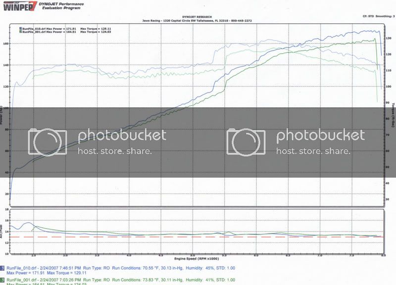

    To answer my own question.. A guy I know who has a GSR hatch with the following mods:
    Skunk2 IM
    Buddy Club exhaust
    DC sports 4-1 header
    AEM intake
    Dyno tuning
    I'll have more stuff done to my car than him, including cam gears and ITR cams :)

    Hmmmm about 21whp from bolt-ons???? Your friend is lying to you he has alot more done than that. Stock GSR's only put down 170hp to the crank not trying to start shit just throwing in my .02
  16. mac_24_seven
    mac_24_seven I trained Trogdor to pWn
    550
    10
    Sep 27, 2006
    Nope... Thats it. The internals have never been touched and he doesnt have nitrous.
    It's a bolt on motor. Now, remember too, that it's tuned. Also, I've seen several dyno's on team-integra w/guys in the 160's untuned, which is what he was before the tuning.
