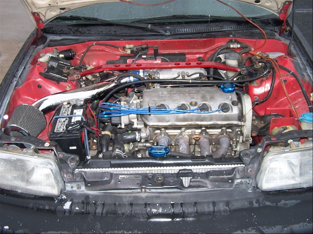

so here is a pic. of the engine. I will upload the other pics as soon as I get a new card reader for the computer

Its definitely been put together and a different valve cover. I believe that valve cover is a D16Y8....VTEC in OBD1did not have HONDA in big letters like yours. I bet its a D15B JDM motor. Its a decent SOHC motor. Just look into a chipped P28 or even a P06 (much cheaper) that has a base map for your D15B VTEC
Can you get a picture of the other side of the block/head and also can you see the head code/stamp?
