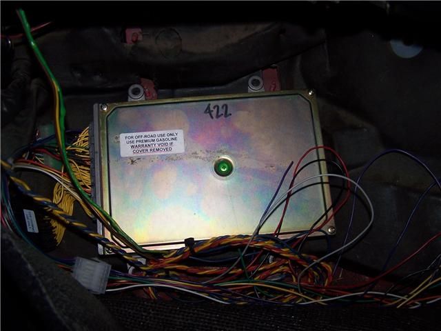

WHAT THE CRAP>.... ECU under carpet

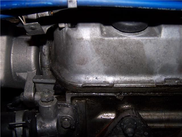

Isn't the D15B carb'd? Its some sort of a Mini-me...at least I think it is. Am I seeing the VTEC solenoid on the other side of the dizzy? That would make me think its a D16Y8 head (b/c of the valve cover) but I could be wrong. Liek K2e2vin asked....look on the Head (not the block) above the header and write down what you see stamped. I know my B16 tells me its the B16 head cast and it also has some circles with numbers stamped in them (been told that expresses the year it was made) so look to see if you head has something similar.
If they were normally carb'd, this one isn't. Here are the numbers:
at thermastat housing: 5211170704
stamped just below head: P08 2
there are three circles with a slash in between them: in those are (9/2) (1/1) (1/0). So a build date of November 10, 1992?

as we said earlier not all d15b's are carbed, not all are vtec, some are 3 stage vtec. The one you have (signified by the P08 stamp on the head) is a D15B single stage vtec. The correct ecu for that engine is a P08; however, a p28 will work, just not as well.

I'm still trying to figure out what computer it does have. Unfortunately I've yet to hear back from teh company who did the ecu. The original oem sticker was removed.
So since you have P08 on the head...I am pretty sure its a JDM motor. I believe its a the D15B thats pretty much a destroked D16Z6...but that's my opinion. I first thought it was the carb'd motor that could have came in your 88-91 with a D16Y8 head (b/c of the valve cover) but I'm thinking no now.
A mini me is a D series Frankenstein motor (like a LS/VTEC)
D16Z6s have P08 heads also. D16Ys have different heads, P2*. We pretty much know it's JDM from the block marking(D15B with no numbers after the B).
What I think it is, is a JDM D15B VTEC, originally OBD1, with D16Y8 valve cover, Y8 timing belt cover, and D16A6 intake manifold. Other things that may be hard to see is the JDM D15B has a "D16Z6" style tensioner(long arm), P08 timing belt(mini-me's use D16Z/Y belts), shorter water pump than non-VTEC D15s, specific "P08" pistons(very noticeable difference from PM3/P03 pistons found in regular non-VTEC D15s), and larger rod bearing journals(D16-sized) with full counterweights. Another thing I noticed is the front water neck is off-angled, causing that kink in the radiator hose. I had that exact same issue with my JDM D15B.

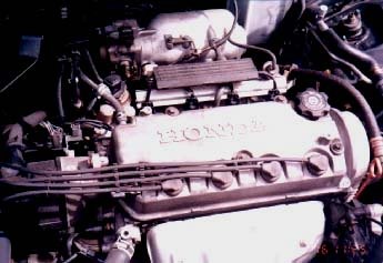

really, my head hurts now... :) so it sounds like I've got quite the wee beast here? I found this article online and very interesting. Could it be possible that the head is the original for the motor?
D15B 1.5l SOHC VTEC
Could this be a 3 stage VTEC EK3? Per this article, these motors had the head with HONDA stamped on it rather than vtec.

you also mentioned that it is a non obd1 computer, what would it be then?
The 3-stage VTEC engine has 2 VTEC solenoids(you can see them in the picture you posted).
Yes, I believe the head is the original. The regular "Honda" valve covers were found on the Y8 which corresponds with the timing belt cover, but we know the actual head is not a Y8 head due to the headstamp.

I have no clue what ECU is in there; is there an adapter harness/jumper between the car's original ECU connectors and the ECU?

I couldn't find any sort of stamping on the ecu. The HONDA sticker was removed by Speed Innovations so there isn't any original info on it. It definitely will not mount on the original holes on the firewall. Hence why it was just kinda hanging out there...

So is the ECU hooked up via a jumper/adapter harness? If you can open it up and take a pic, or possibly just compare it to a pic of OBD1/2 and OBD0 ECU connectors.

computer and wiring
