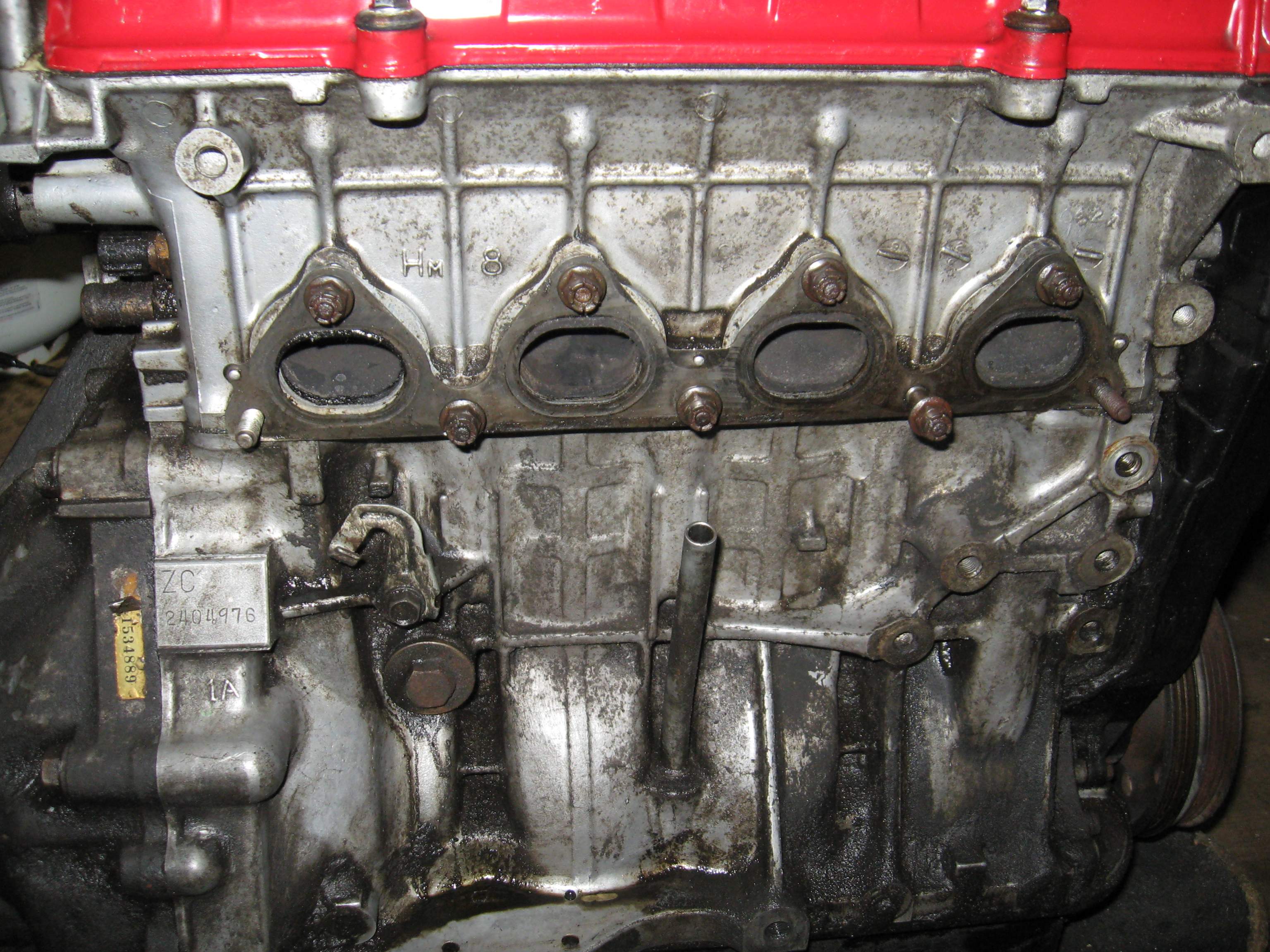

pappaj New Member Apr 5, 2009 #1 Can someone tell me what year this motor is, or point me in right direction to find year. I need to order head gasket for the motor. Please help. I'm new. Attachments IMG_0874.jpg 767.4 KB · Views: 217

civicious Buck Futter VIP Apr 5, 2009 #2 Regardless of what year it is, you'll need a headgasket for an 88-89 Integra D16A1. check out www.thezcr.com , they've got tons of info/parts on ZC's
jlicrx Senior Member VIP Apr 5, 2009 #3 that engine has a head that was manufactured in 1989, so it is more than likely from a 1990 model year JDM CRX/Civic Si
pappaj New Member Apr 5, 2009 #4 thanks. just the info i needed. now I can order the head gasket and get this motor out of my garage.
