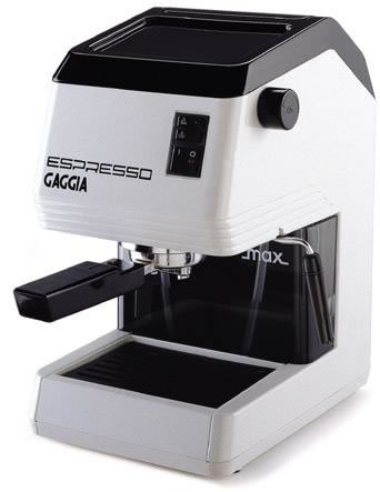

I have an old Gaggia espresso machine that I just rebuilt. Rebuilding helped it a lot, but it still refuses to pull proper shots. How do you "calibrate" your machine? Mine just has on/off, steam on/off, pump switch, and a knob to control the steamer. I think it's either the temperature or the pressure that's off, but there's no way to adjust that. Suggestions?

Which gaggia? Inside most machines there's a regulator valve that sometimes drains excess pressure back to the tank. You can try to find a manometer to check for the proper (what's it, 9 BAR) at the grouphead, if it's not 9 BAR at full temperature, fiddle with it. It's a hugely time consuming process, but I feel it's worth it.
When I dissassembled it, it was filthy and full of calcium buildup. I mean FULL. It took a full day of scraping and scrubbing to get it all out of the boiler. It's a very old machine and wasn't taken care of.
I found the valve which was a rubber stopper on a spring. It was in a threaded sleeve that could be adjusted, (I just thought of that now) but was tightened all the way, so that's how I rebuilt it. The rubber was old and hard, but I didn't have a replacement piece, so I just sanded it lightly to freshen the sealing surface. The pump is old and kind of loud, but makes enough pressure to push the valve open, maybe I just need to adjust that spring. How would too much pressure effect it?
Too much pressure, and it'll be bitter. It sounds like the valve you've got isn't diverting enough, try loosening it up a bit, then pull a shot, but be sure to keep everything else EXACTLY THE SAME. The name of the game here is to control all variables. When I slip up, like I did with the one in the pictures, it'll taste like ass.

The seal between the boiler and grouphead had so much corrosion, the aluminum was pitted a few mm deep. I took a coarse file, fine file, then progressively sanded it to remove the pitting and make the surface smooth enough for the o-ring to seal.
When I first put it back together, just to test it and see if it works and to check for leaks, all I had was drip grind. The first few shots had a very metallic flavor, which I immediately assumed was metal shavings that I left behind while cleaning it. That didn't make sense at first because I know that I got ALL the various debris out of that thing. I was very thorough with the disassembly and cleaning. It makes sense that the grind was too coarse, since that flavor went away as soon as I started using espresso grind. I think the grind is good, the beans are good, my tamping may or may not be, the pressure definitely needs adjusted, and I need to check the temperature. I read optimal is 199°-201° F so I need to make sure it's close to that. I tried to check the temperature with a kitchen thermometer, but I don't know how accurate it was. Before cleaning it read 150° and after cleaning it jumped to 170° I suspected the heating element, but it makes steam, so it's gotta be hotter than 170°. I dunno, what's the best procedure to read the temp coming out of the grouphead?
Did you run any descaling sollution through the machine? Sometimes it takes some good strong descaler to get all the crap out.
I don't know if your pressure is proper. This should be your first worry, the thermostat is probably fine, because what you want is the temperature of the water inside the grouphead, not the temp of water coming out of the portafilter. Something you could do to check water temp is to somehow put a thermsistor/thermometer inside the portafilter basket.
http://myweb.tiscali.co.uk/coffeetime/userfiles/OPV_Valve.pdf
^^ There's some good infoz on pressure diverter valves.
After scraping the hell out of it, I filled it with vinegar, ran it til vinegar came out, let it sit for a while, then flushed it thoroughly.
I guess it's time to take it apart again. I think I can disassemble/reassemble this whole machine in less than 15 minutes. Next up: hanging upside down blindfolded. :)
