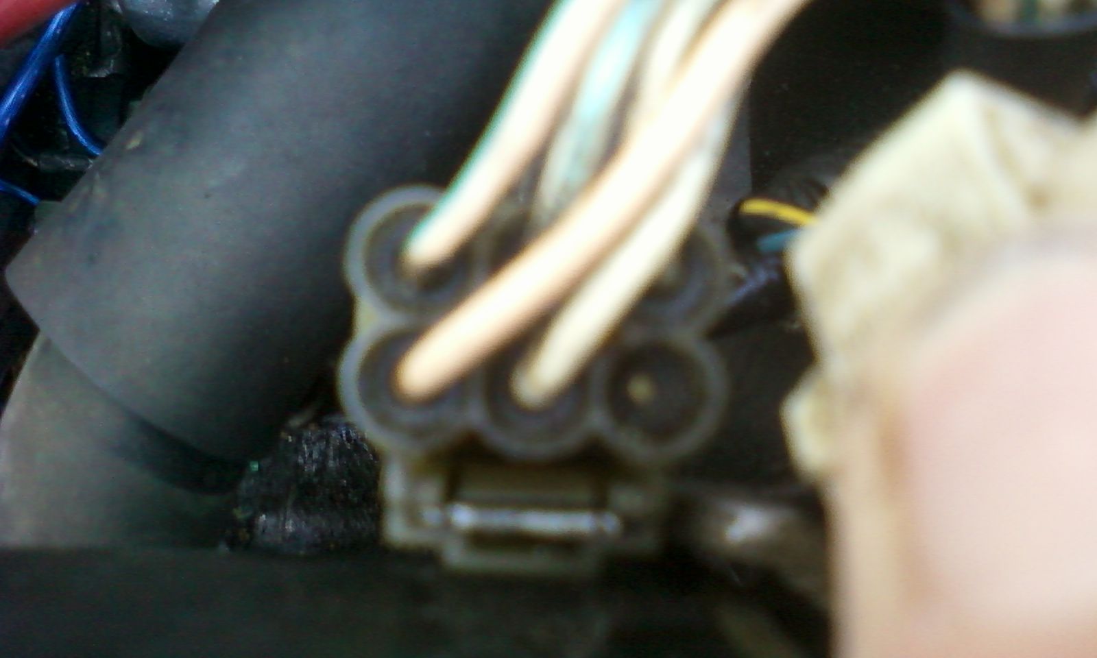

  19. danielvaughn123
    danielvaughn123 New Member
    39
    May 13, 2011
    Richland, MO
    Can I cut the plugs off the square connectors on the distributer and splice the wires together to the round plug on my other distributor?

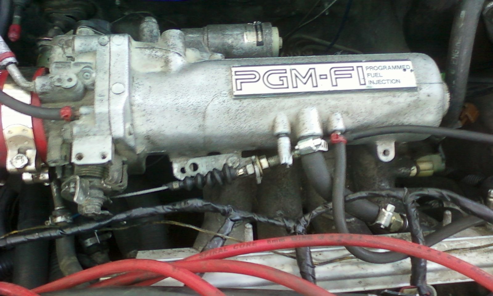

  20. danielvaughn123
    39
    May 13, 2011
    Richland, MO
    This is the distributor and intake I have on my car now. It runs but when I rev the motor to about 3-4 thousand rpms it want's to act like I'm continuously pushing the pedal. Sounds like vvrruuummm, vruum, vruum.
