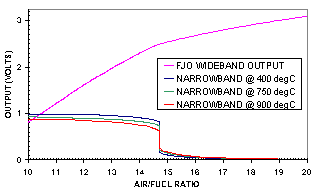

    most hondas, with the exception of the 5-wire VX and HX, run a Narrow band o2 sensor, either heated (4-wire) or not heated (1 and 2 wire).
    Most wideband meters have a 0-5 volt output proportional to air fuel ratio. Noarrow band units, like the stock o2, run close to 1 full volt for almost all ari fuel ratios that a car could possible run "well" under. That output is fed back into the gauge or tuning unit and can be converted into a precise air fuel ratio. The stock O2 sensor is very inaccurate for anything other than 14.7:1 airfuel ratio.
    as you can see, lean or rich, its still throwing back just under 1 volt. it's near meaningless.
