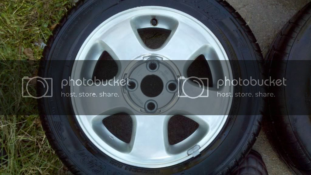

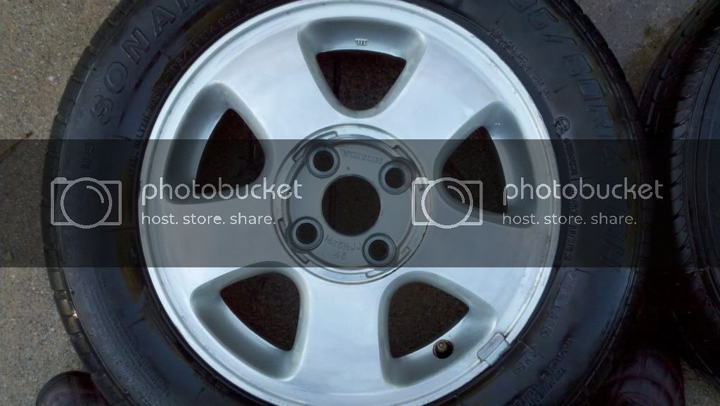

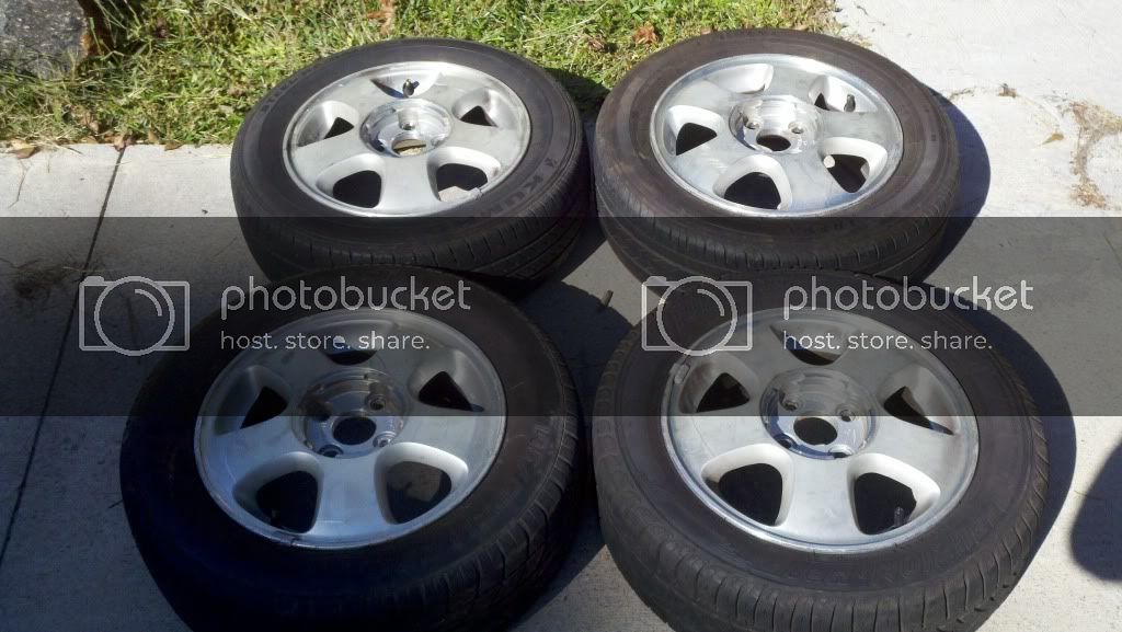

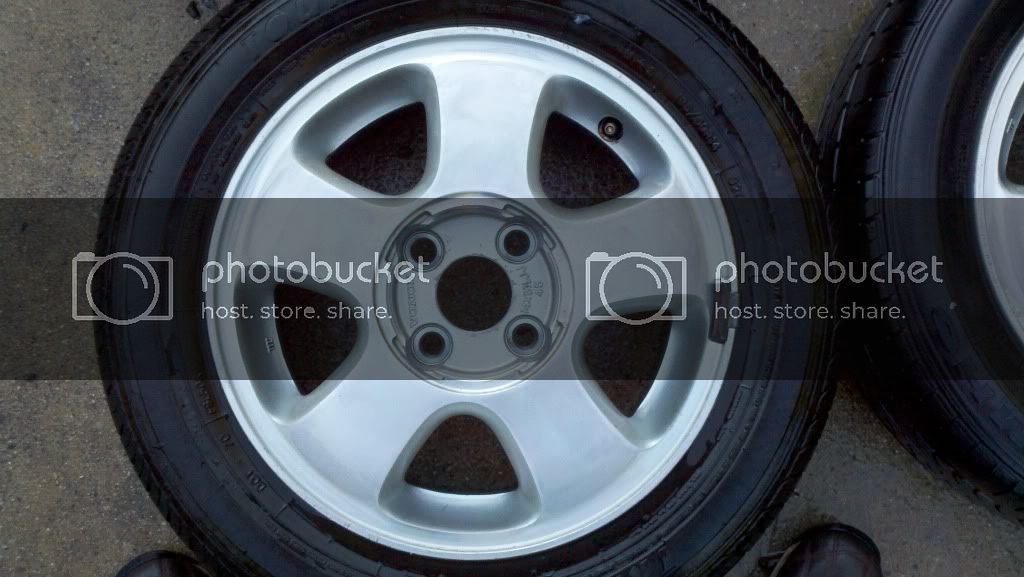

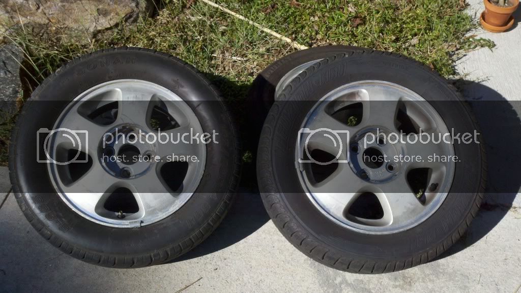

Got some new wheels. I am tired of the heavy ass 17s that I have rollin on so I picked up some del sol si wheels. I spent the evening sanding out a couple of scuffs and getting them ready for paint. I am thinking black with with a red lip and red H. How do I take the weights off that are connected to the lip?
Yeah I just happened to take a look at the local forum and saw them for sale. I wasnt really looking for anything. I just happened to check the for sale section and what do you know. $100 with usable tires. I will be getting a new set of tire soon though. The set that is on right now are all miss matched.
