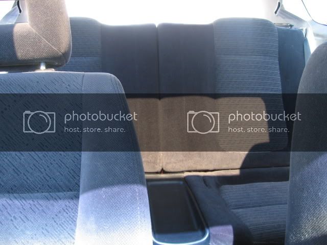

i have 98 rear teg seats in my 92 si, there is gaps but i use some foam & black material to close the gaps up & relocated the back backet to the other side so i didn't need to drill holes in my floor, also need to make bracket for the front of the seat to hook into the floor, not to hard to do. they fit nicey now :) heres a pic
