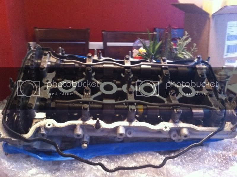

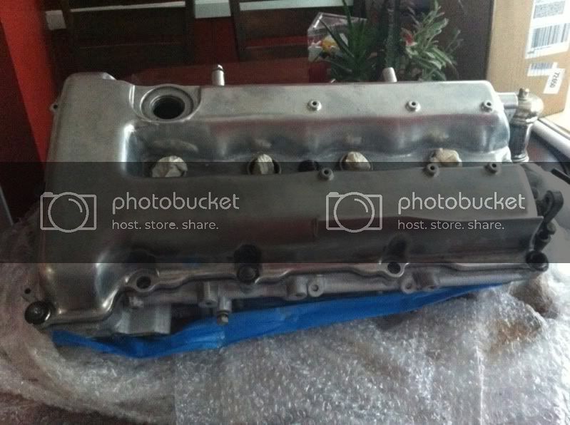

New head came in

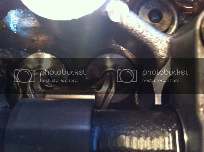

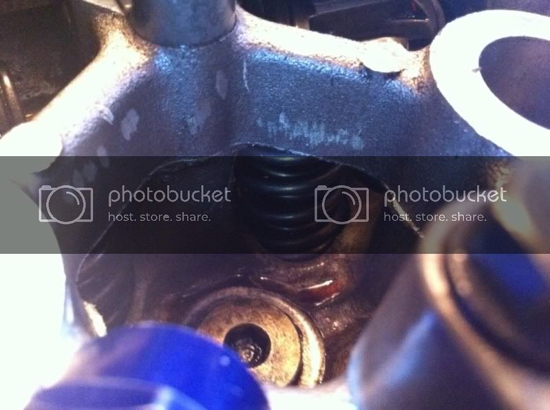

Light port and polish
272's
Dual valve springs
Titanium retainers
-I'm waiting to find the right standalone before swapping my head out, but it's here and ready to go

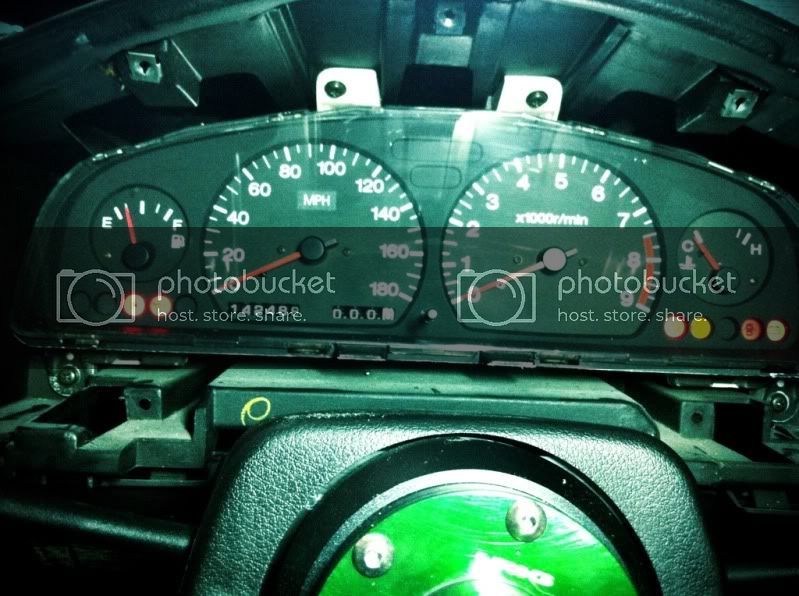

new (old) shiftknob (its been in my last 15+ vehicles), fixed the radio, fixed the turbo timer
AND....finally know how fast I'm going (UKDM cluster))
