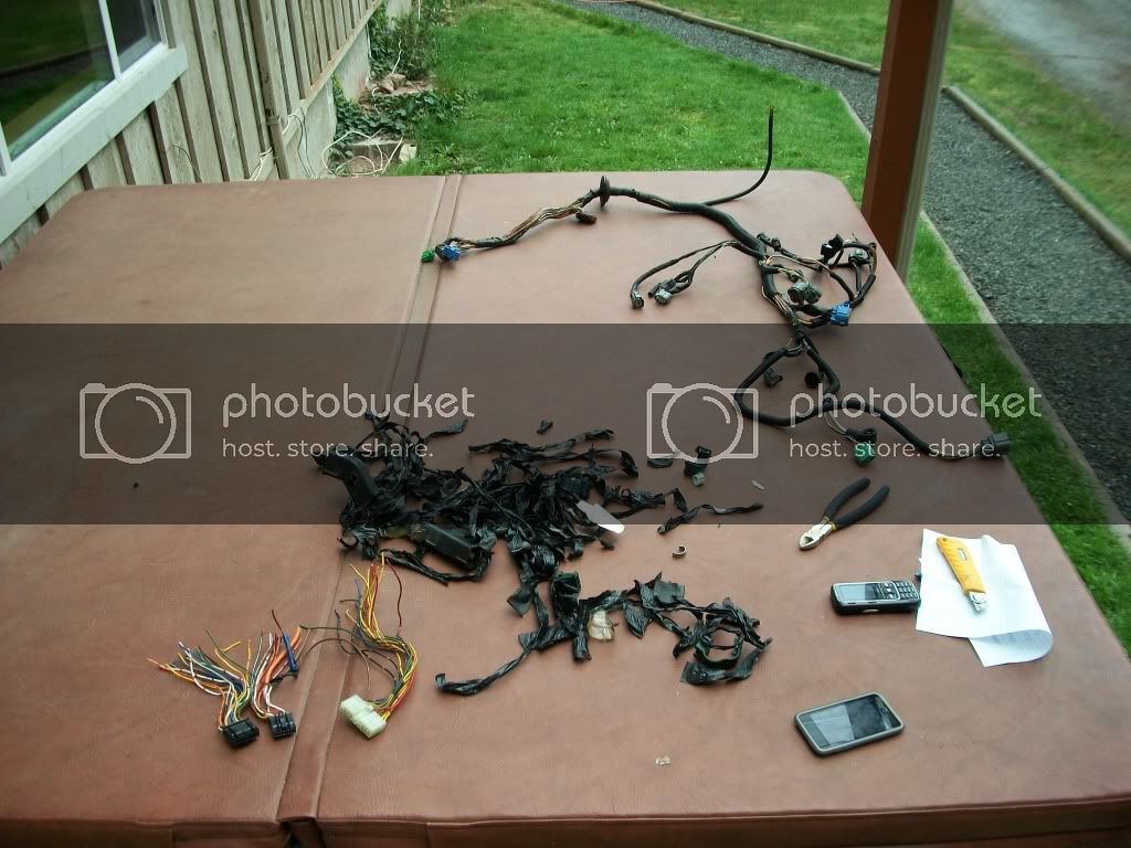

I've already tucked the drivers side of my bay, now I want to do the passanger side.
I have a complete 5 speed D16Y7 harness OBD2 harness and OBD0 ECU plugs. Will that harness be easy to convert to OBD1 and VTEC? I would keep my OBD0 to OBD1 conversion harness and just solder the OBD0 plugs onto the OBD2 harness.
Where could I hide the fuse box? In the glove box?

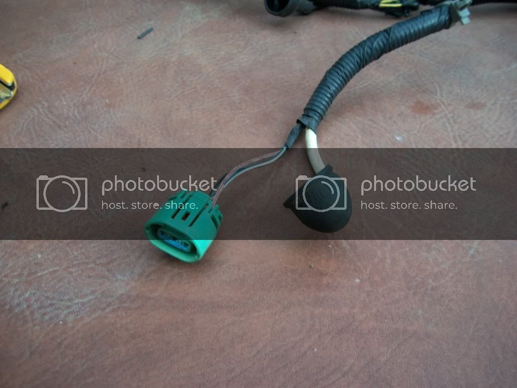

Came up with some issues. I'm missing some plugs, forgot I cut them lol, and quite a few differences. But I had to expect that being OBD2.
Have to put on a tempature sensor, get rid of the extra o2 wires and the extra mystery plug.

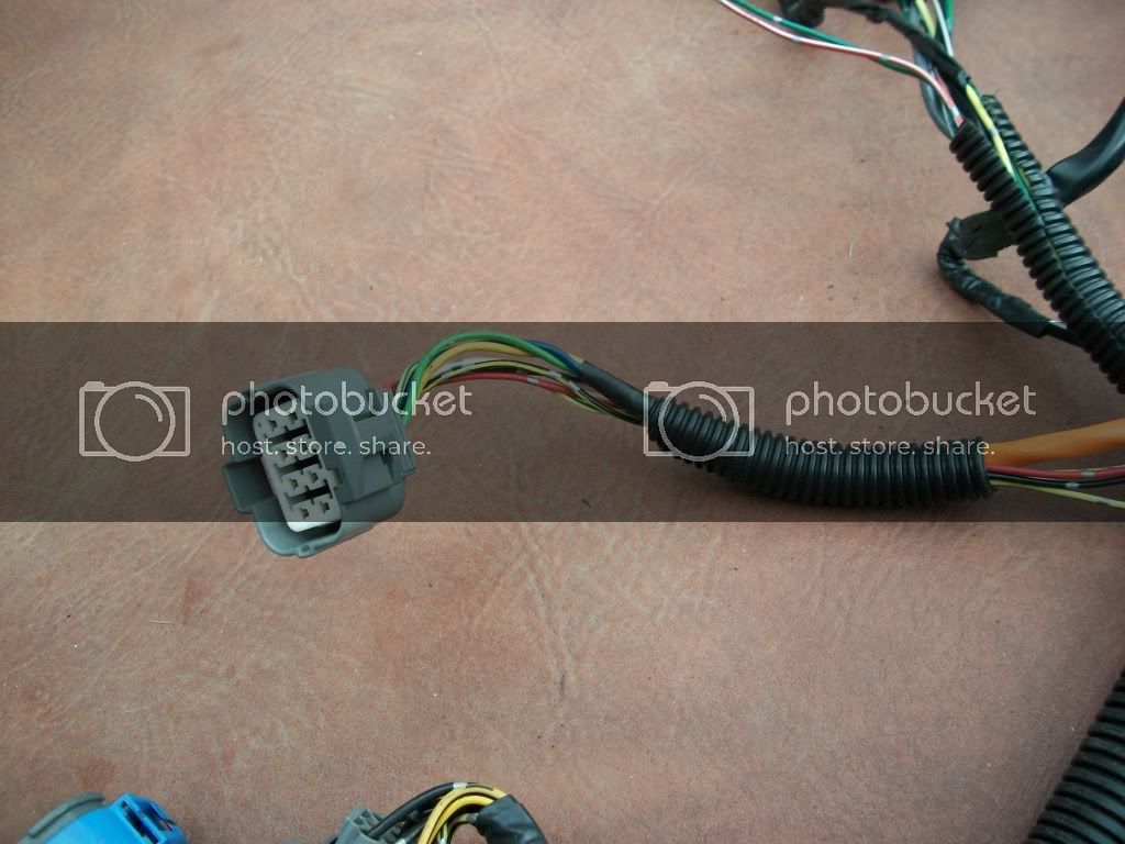

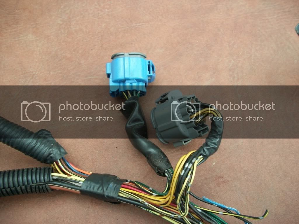

Dizzy has one plug vs. 2 plugs and 1 more wire on my CRX dizzy.

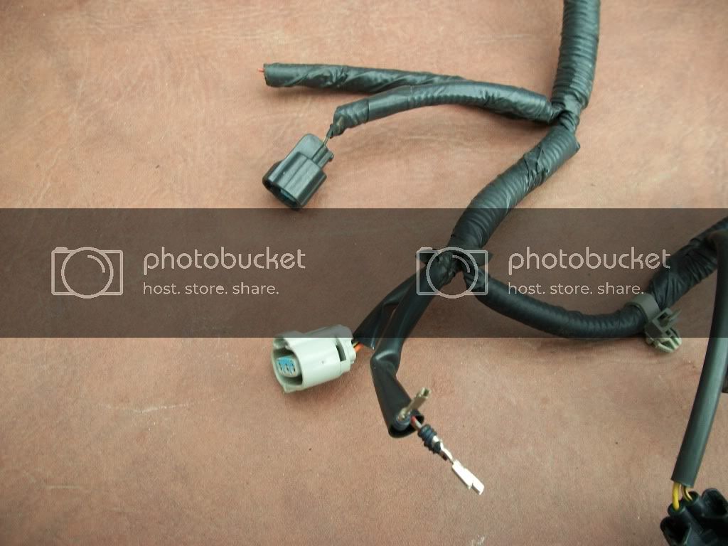

Big, random plugs.
Alternator plug is different and has 1 less wire than my CRX alt plug.

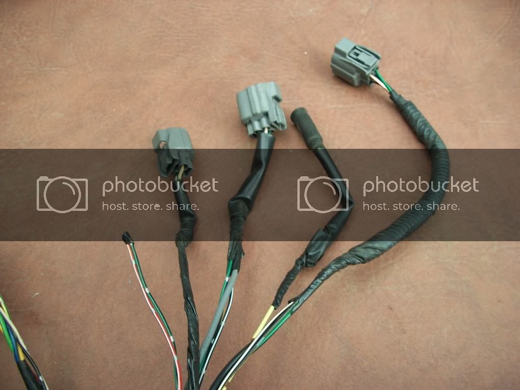

Unknown plug. Maybe TPS?

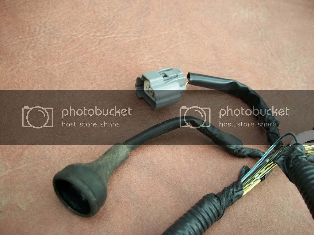

Have to change the injector plugs.
Have to put on the MAP plug and some more unknown plugs.

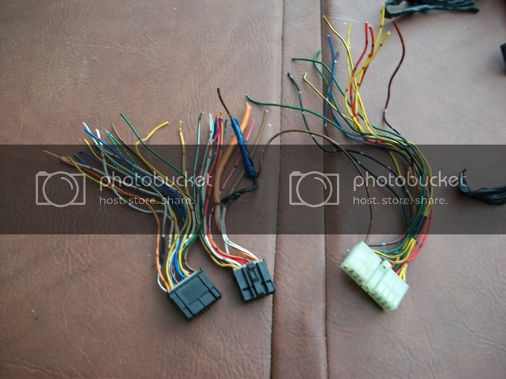

Fail on my part because I haven't searched yet...going to try and swap over the ECU plugs now. A diagram would be nice. **wink**wink**

I think it should be possible to use the OBDII alternator. Just re-wire it to match the colors. My stock CRX harness has 4 dizzy wires and my B16 alt had 3 wires but it will worked. I just cut off the odd wire.
