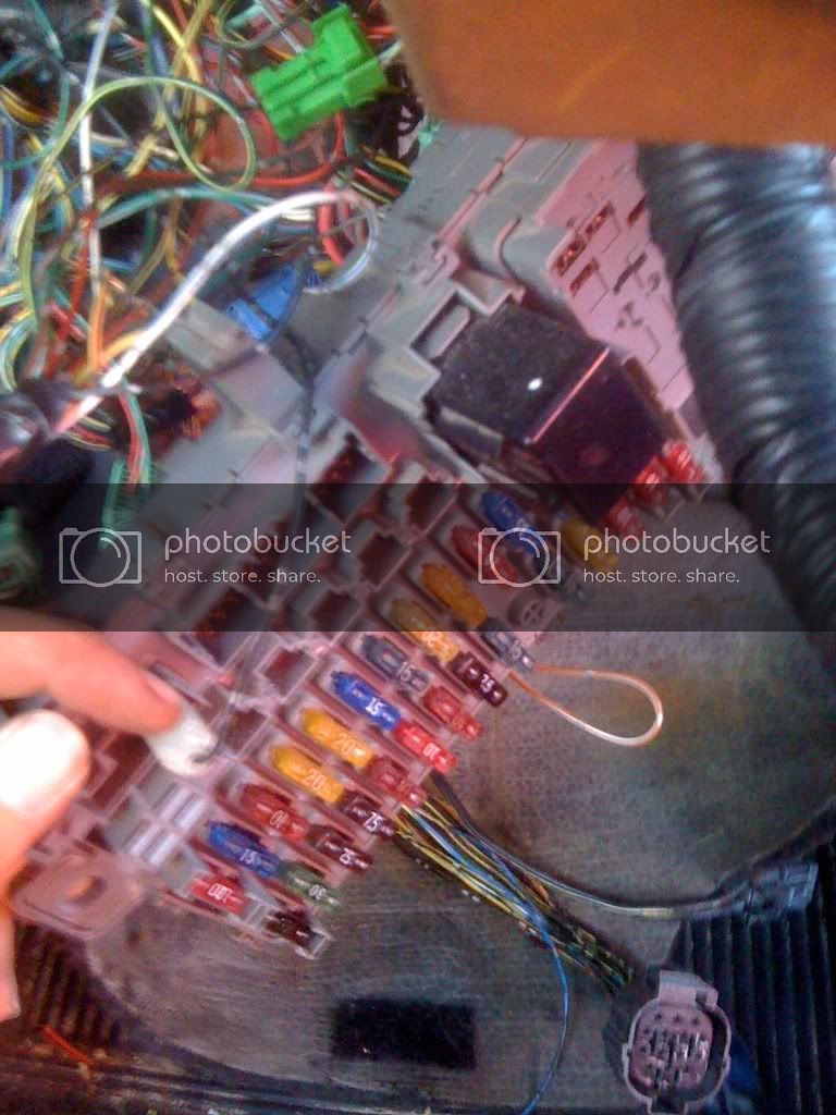

It's all in the wiring. Only things I have done is get it back to running condition. These things are things I am discovering as I am getting ready to have back on the road. I really don't know what to say other then show you a couple pics of things I think don't look right.
That little black wire that runs to one of three metal contacts is the " weird " part about the fuse box. Without it plugged in I get no power to any of the cluster. Also if you can kinda see on the other side of the fuse box there is a section missing.. under where the big black wrap is on the other wires.
And yes, after review the car and getting one my friends who knows he is stuff with honda's agrees with your verdict of " village idiot "
Focus on the part that is missing on the fuse box. Would that have something do with all of this? And also the fact that when you plug the battery up all the turn signals come on an stay lite up is just weird.

Well I figured out what the problem was.
For the longest I could not find the male plug to go into the hazzard switch. FINALLY today I found it plugged into the fuse box ?!?! So after plugging it up.. everything works fine. What a weird mess that was.
