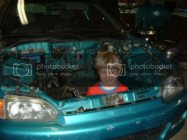

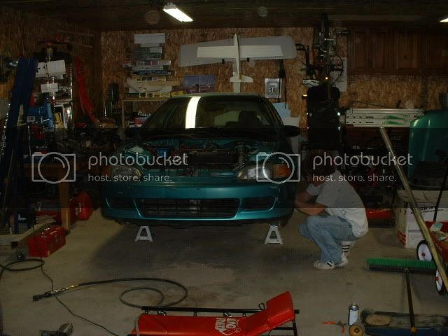

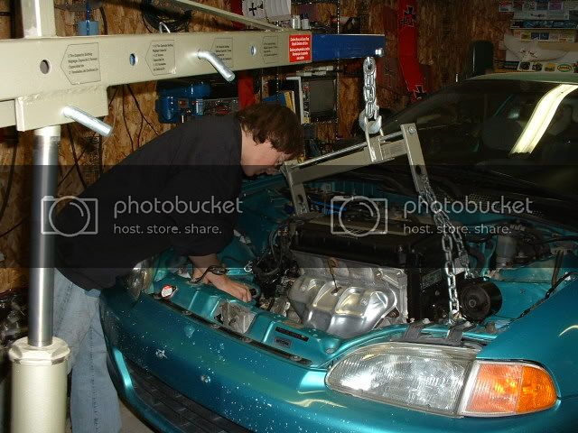

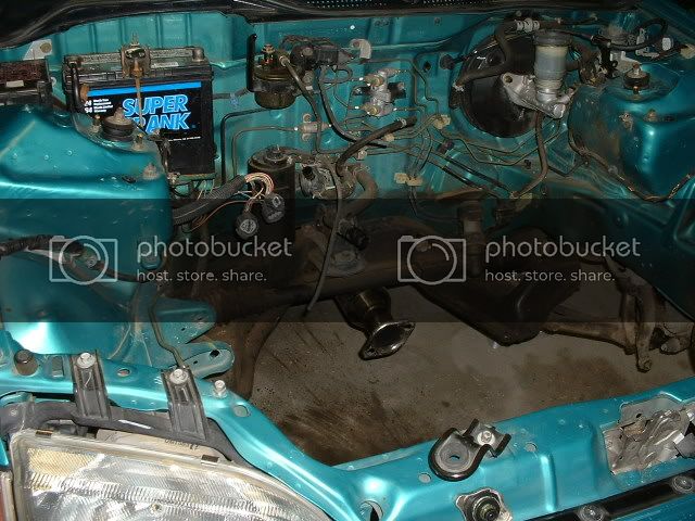

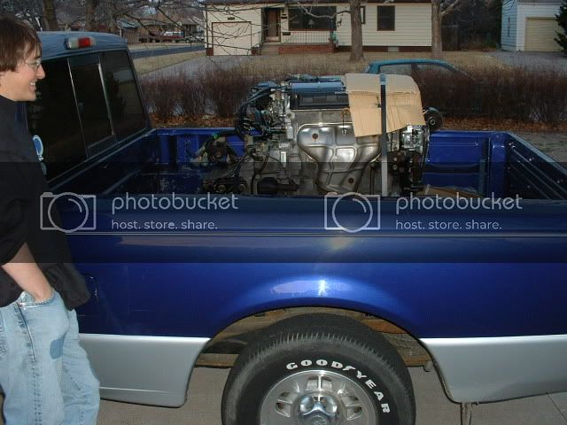

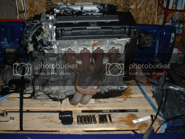

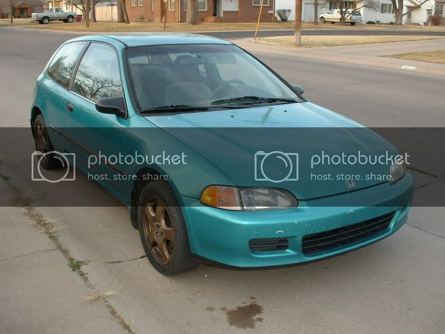

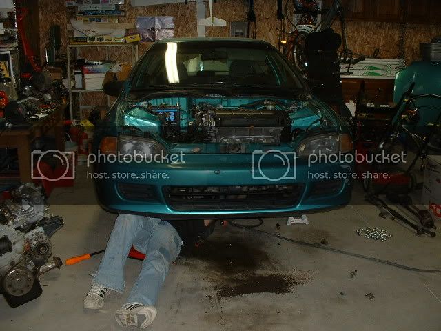

We started last night after work and school. We should have the engine in sometime tomorrow. I will post more pics as they become available.

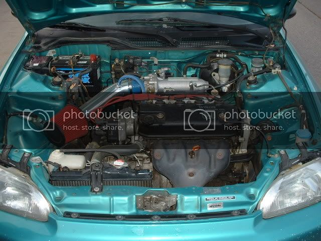

The Victim
The swap

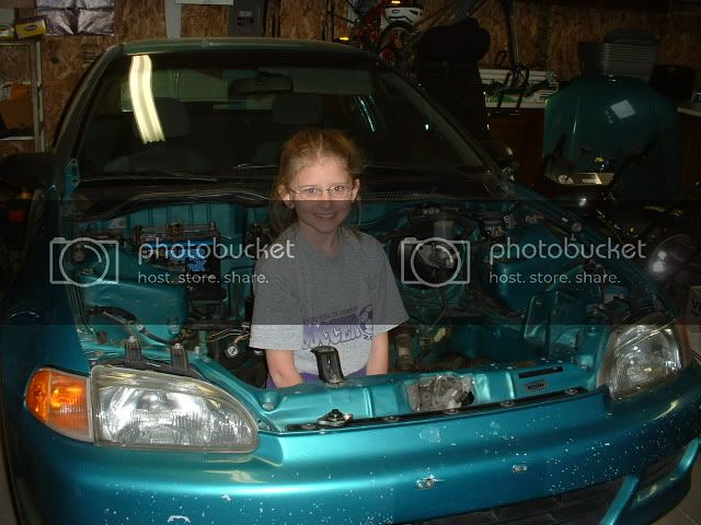

The tired d

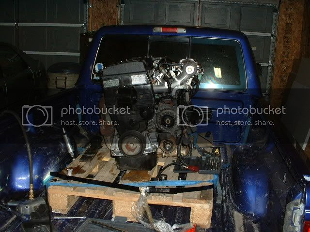

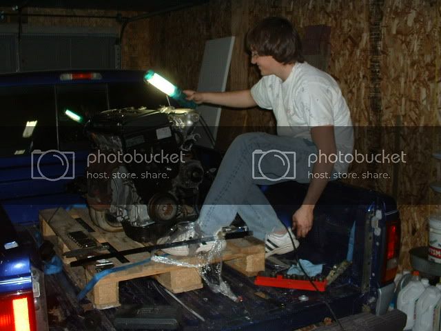

First look at the transplant

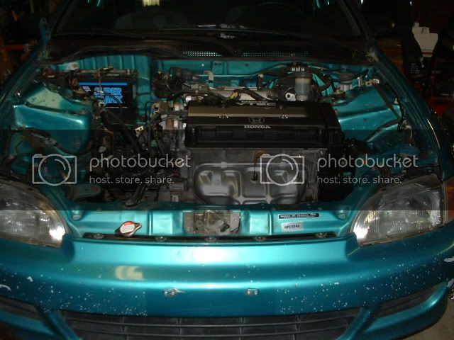

The stage

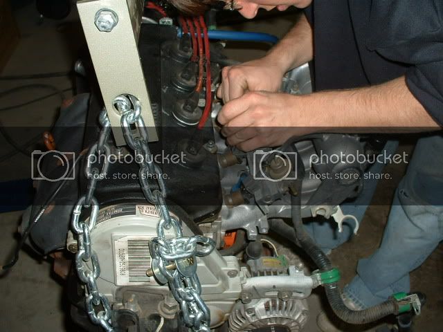

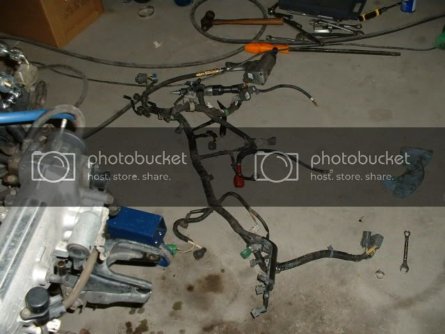

The last pics show him puling the harness off the old engine and routing the harness onto the new engine. I wish I would have done this on mine when the engine was out of the car.
Quoted post[/post]]
Oh yeah. DEFINITELY makes it easier. Especially if wires need to be extended or added on. Best time to keep it looking like it came from the factory like that.
Nice going man, let us know when you get it up and running. BTW thats a purdy engine crane :ph34r:

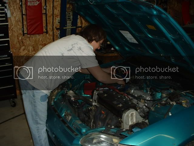

Success!!!!!!!!!!!!! It runs. Will finish up tomorrow.

Got the wrong upper rad hose. Improvised by cutting up the old lower hose. Also have a broke knock sensor so we started it on a vtec converted p06 to avoid a code. Steve at hmotors wanted a pic of the broken sensor before we started removing the harness (too late)and started talking about how long it would take to get it to us. I got the impression that helping us out was not in his interest. We have already got one coming through another source.

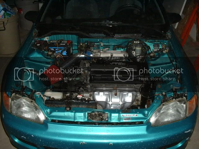

Seems to run good. We are a little disappointed in the shift linkage. We were sent a poor reproduction shift linkage with the swap. (Not the stock honda that came with my first swap). It came with a lot of slop in the bushings and the shifter end needed to be bent to try to shorten the linkage a little. It is a little too long and puts the shifter in a bad position. Very far forward. Also the welds look cold and the material seems soft, I am concerned that it may break easily. There was a big difference in the two swaps I have gotten from hmotors. The first one looked as if it was freshly cut out of a car and palleted. This one looks as if was peiced together out of what was available.
Just looks right in there.
Well got the swap done. I think he is going to just spring for the stock shift linkage. It is running very well otherwise. Woodster definately has the "V-Tec Grin"
I definately have that Vtec grin goin on. Im so damn psyched to have this in, gonna be my new favorite toy.
