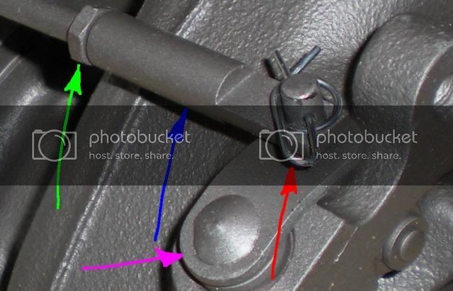

the greddy td04h/15g wg actuator is adjustable
longer = less boost
shorter = more boost
