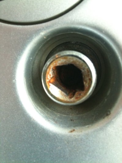

Lost my key and need another one so I can change out my tires.
Here is a picture of the lug.
if u cant get another lug key, u can get a lug removal kit from prob any auto parts store. u just fint the right size, bang it on with a hammer then put a impact gun on it and baby the gun and it will come off.
for all we know you could want it to jack some wheels .. gl on your search, my guess is you wont find anything or anyone willing to help
take it to a tire shop and tell them you lost the key and need to take them off.. they'll get it off
