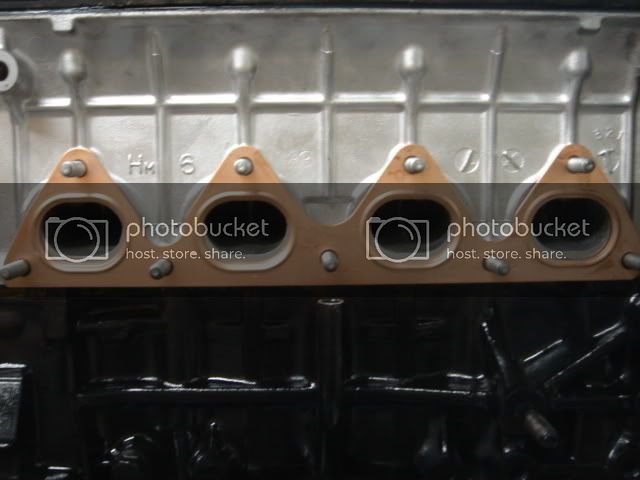

    The ports are slightly offset on the DOHC D's like so:
    Otherwise than that, it will work.

    thats what it was^ i was told to enlarge the ports on the manifold,or use the plate,
    but like efhonda said,,just get the header for your car,,from ebay
