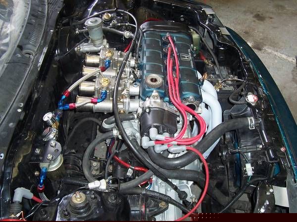

    we had the same problem when we converted our ZC to carbs - we tried using the vacuum advance distributor from the 86-87 Integra D16A1 - it would run, but not like we thought it should - we finally spent a bunch of money on an MSD system which works perfectly

    exactly - the D16A1 distributor has two vacuum advance mechanisms on it, along with a centrifugal advance - one mechanism is strictly vacuum but only advances the timing by 6 degrees - the second one is partly controlled by the ECU (which we don't use) through a solenoid that controls the vacuum to the mechanism based on readings from sensors on the engine, i.e. coolant temperature, RPM and load - this advances the timing by another 12 degrees - without the ECU, it just didn't work right - we could have probably figured it out eventually with a distributor machine, but after countless hours we got tired of messing with it and just spent the money on something we knew would work; and we were already using some of the MSD items like 6AL ignition - it is quite a bit of money to do it the way we did - it could have been done for less - we use between 34 to 40 degrees total advance on the ignition but we are running at altitude of 5000 to 6000 feet above sea level
    one thing that you are going to need is a quality, high volume, low pressure fuel pump - the carbs only need 3-5 psi pressure, but need a lot of volume - anything more than about 5 psi and they will let fuel by the needle valve causing flooding - we run ours at 3 psi with a Carter Rotary Vane 4 psi pump and a Holley fuel pressure regulator
    to use the D16A1 distributor, you also need to swap the #6 intake camshaft bearing cap with one from the 86-87 Integra - with that part you can get the top bolt on the distributor bolted up - the other two bolts still won't line up with the head but it seemed to work just fine with the one bolt - that part may be harder to get than the distributor - you can find these D16A1 distributors for around $50 U.S. on ebay.

    our system is kind of elaborate - we have the MSD 6AL ignition with the MSD 8979 Programmable Multi-function Ignition Controller and run the MSD Blaster 3 ignition coil - the 8979 ignition controller controls the ignition and is very versatile and allows us to program a timing curve by setting the advance at each 100 rpm (we could also have a different curve for each cylinder, if we desired) - it also has 3 different rev limiters and can set shift lights for different RPM in each gear: plus a lot more - the 8979 that we have has been discontinued - MSD now offers the Digital 7 ignition which incorporates both the 6AL and the 8979 into one unit - the 8979 fires the ignition through the coil - to trigger when it fires, we use an MSD crank trigger which we mounted on the oil pan rail on the front of the block and is aimed at the back of the flywheel - we installed two MSD flying magnets into the back side of the flywheel at 180 degrees apart, which in conjunction with the crank trigger tells the 8979 when to fire - since the 8979 controls everything, we removed everything from inside the stock distributor except for the shaft and rotor, which directs the spark to the spark plug wires - everything is programmed into the 8979 by use of a laptop computer
