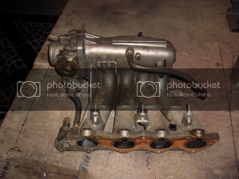

    This is the manifold i got with my DOHC ZC, will this work on my car. I have a 90dx that is now wired for mpfi. Everything is working great but i want i ZC.
    Why is the throttle body different, and the fuel rail is the same as a 92-95 civic. Anyone else using this manifold on their civic?

    thats the OBD1 92-95 ZC (manifold)
    The 88-91 EF ZC has 3 vacuum lines coming from where that 1 big one does...
    92-95:
    88-91:

    That`s what i thought, but it`s hard to find good info on the net. People say there`s no such thing they only made them from 88-91.
