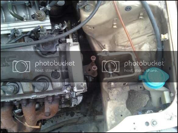

    hey i just order a d16z6 and i recived a zc sohc vtec and was told there the same so i was like ok sounds good so i droped the motor in last night and the drivers side motor mount wount mount up so i was wondering how i got about mounting it

    Pretty sure you just pull the timing cover off, unbolt that mount that's already on it and re-use your old one. I didn't have the proper mount for mine either so I used the one off of my D15.

    thanks i didnt know it was that easy to bad i got rid of my old motor and every thing guess that means time to hit the junk yard
