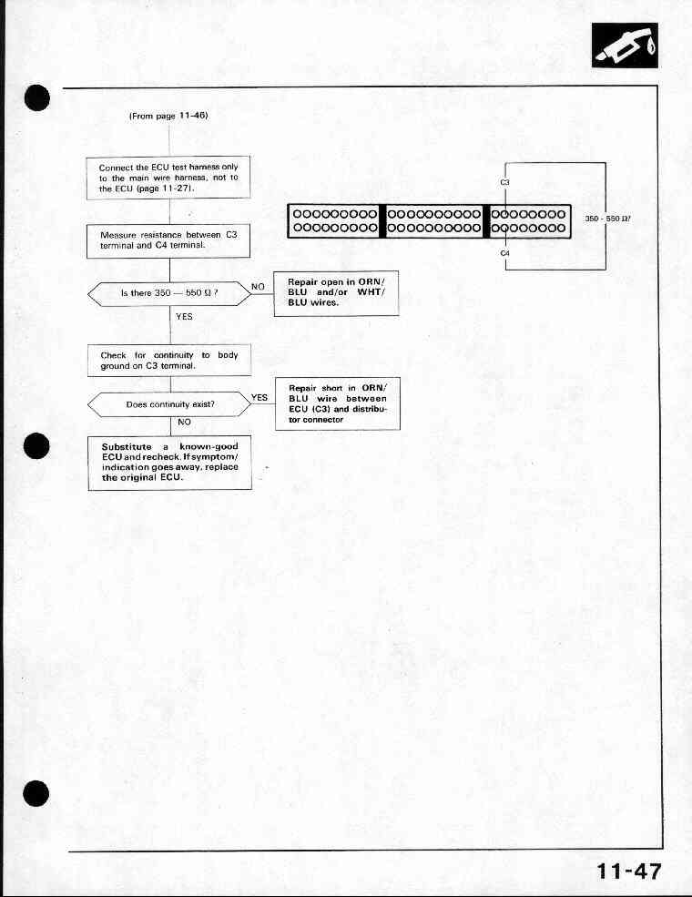

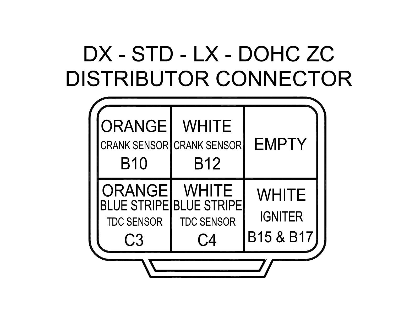

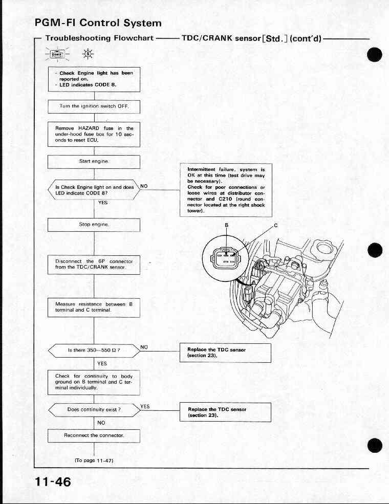

not an uncommon problem with a lot of aftermarket distributors - they seem to have the internal wiring amiss - wires running to the wrong sensors- try this:
