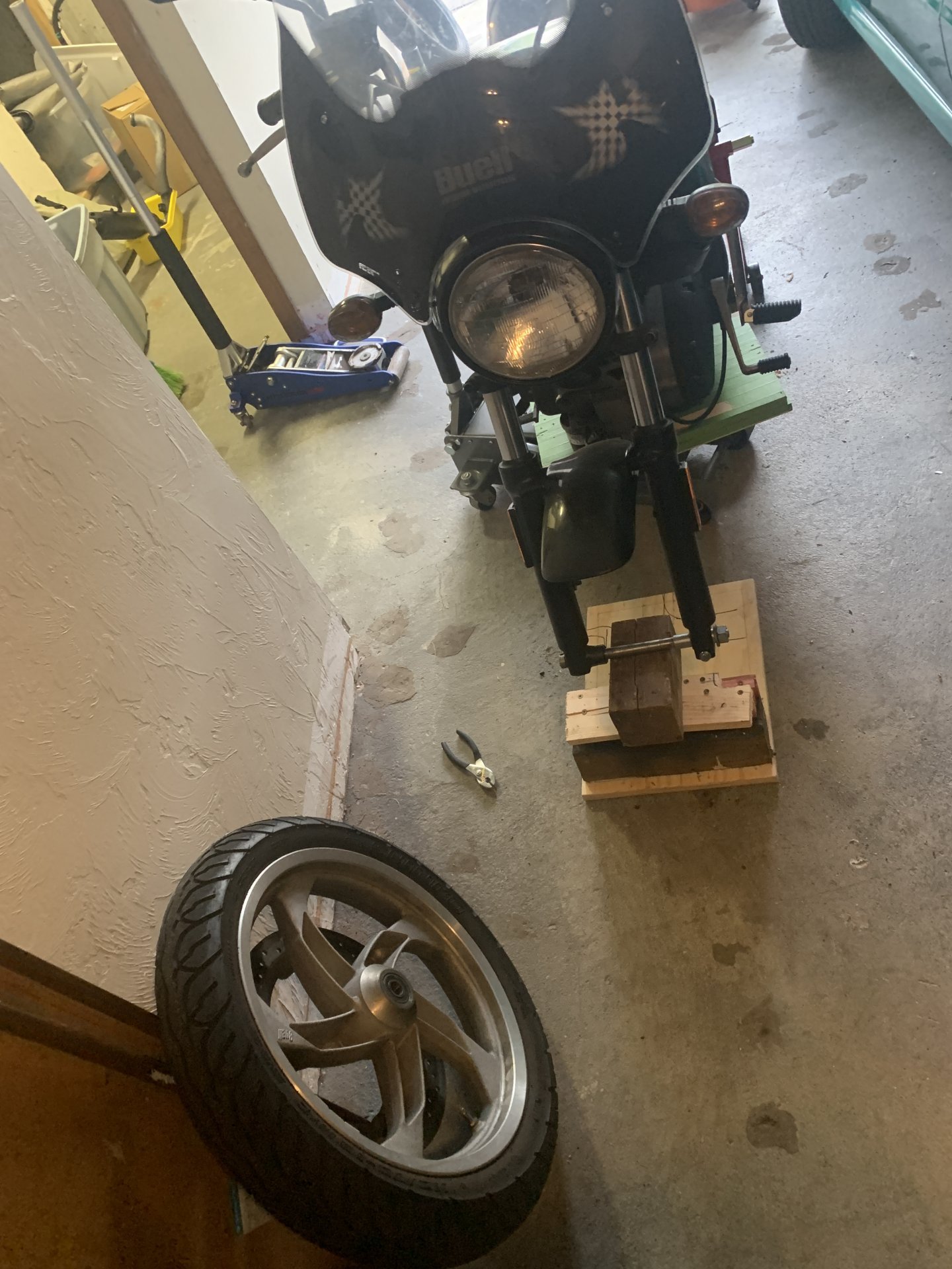

new front tire is in, just gotta get it off the bike and swapped out somewhere.
