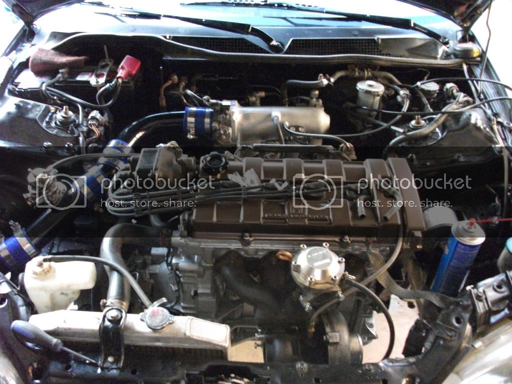

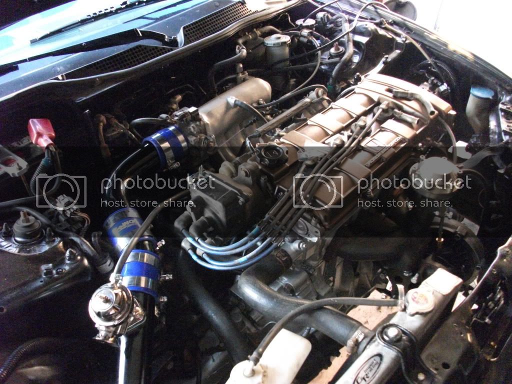

You're welcome! Looks nice. I been flirting with the idea of a turbo lately.....glad to see you got yours going. Is it running?

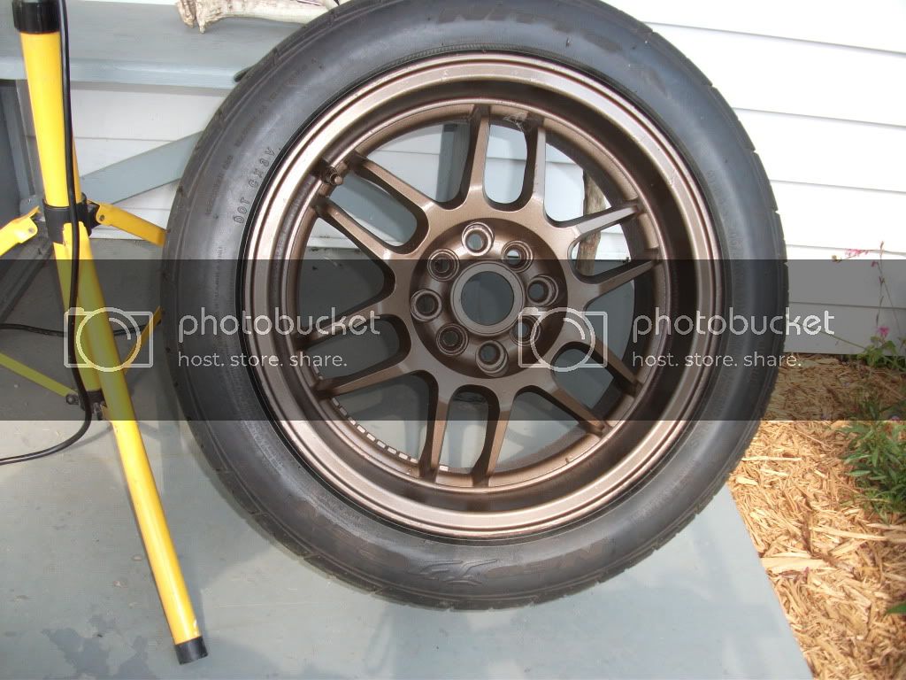

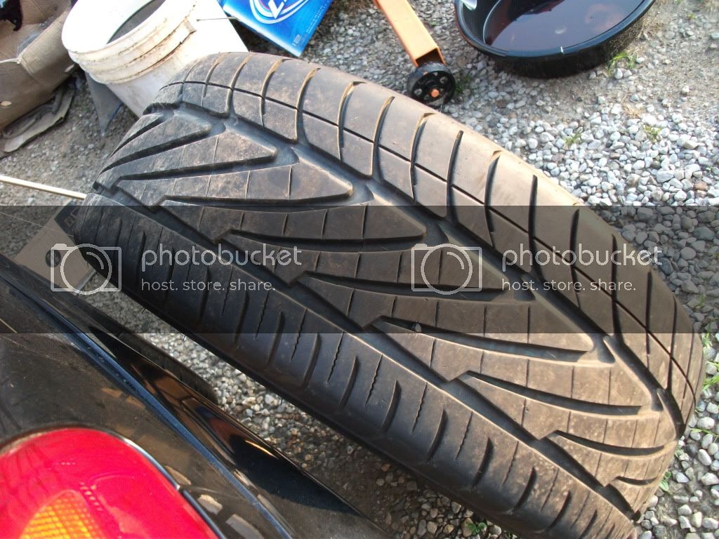

Tall indeed (IMO)

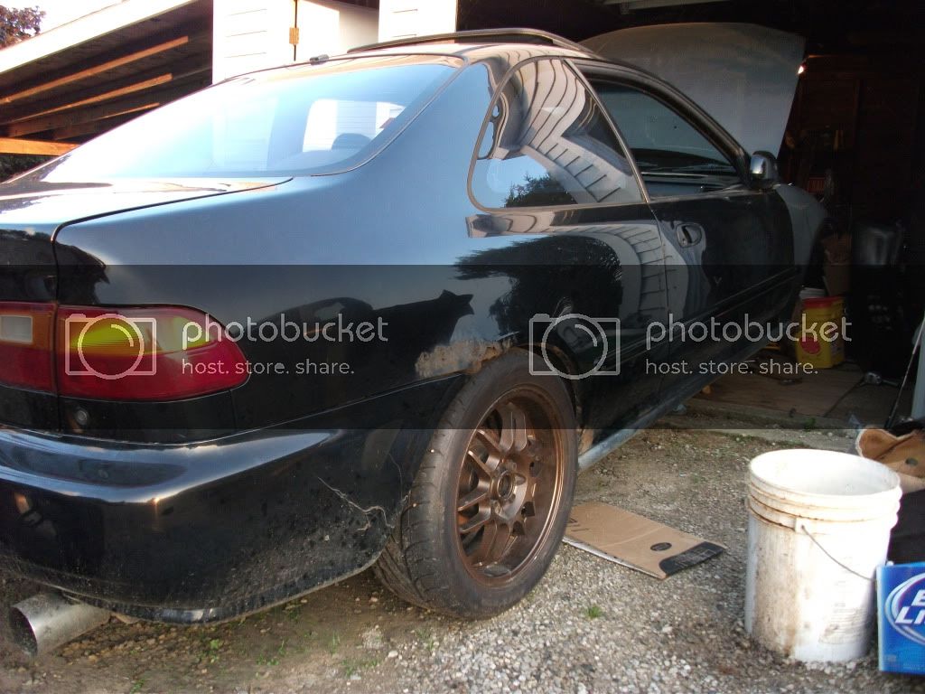

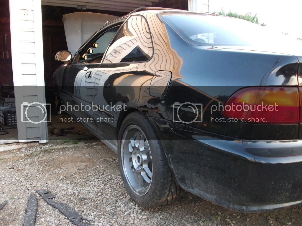

205 45 16 is the biggest I would go. I have 205 50 15 on mine and I rub a tiny bit (lowered 2.25")
Boosted4Life
Ya. they are a little big but i figured it would help with traction a little. They rub a bit when you hit a big bump, otherwise they are good tires.

Ok, just want to make sure I read the sidewall correctly- I have 205/50-16 on the wife's xB and they're 24.1 inches tall- the EG chassis expects a 22.7 inch tall tire. I know the wheel wells will absorb a tire that large- but it's pushing it!
Boosted4Life
Ya lol i agree it's pushin it but hey i don't drive it much and i think the car will thank me in the end for givin it a little bit more rubber to leave on the ground ;)

Oh, definitely. Just make sure to correct the speedometer.
