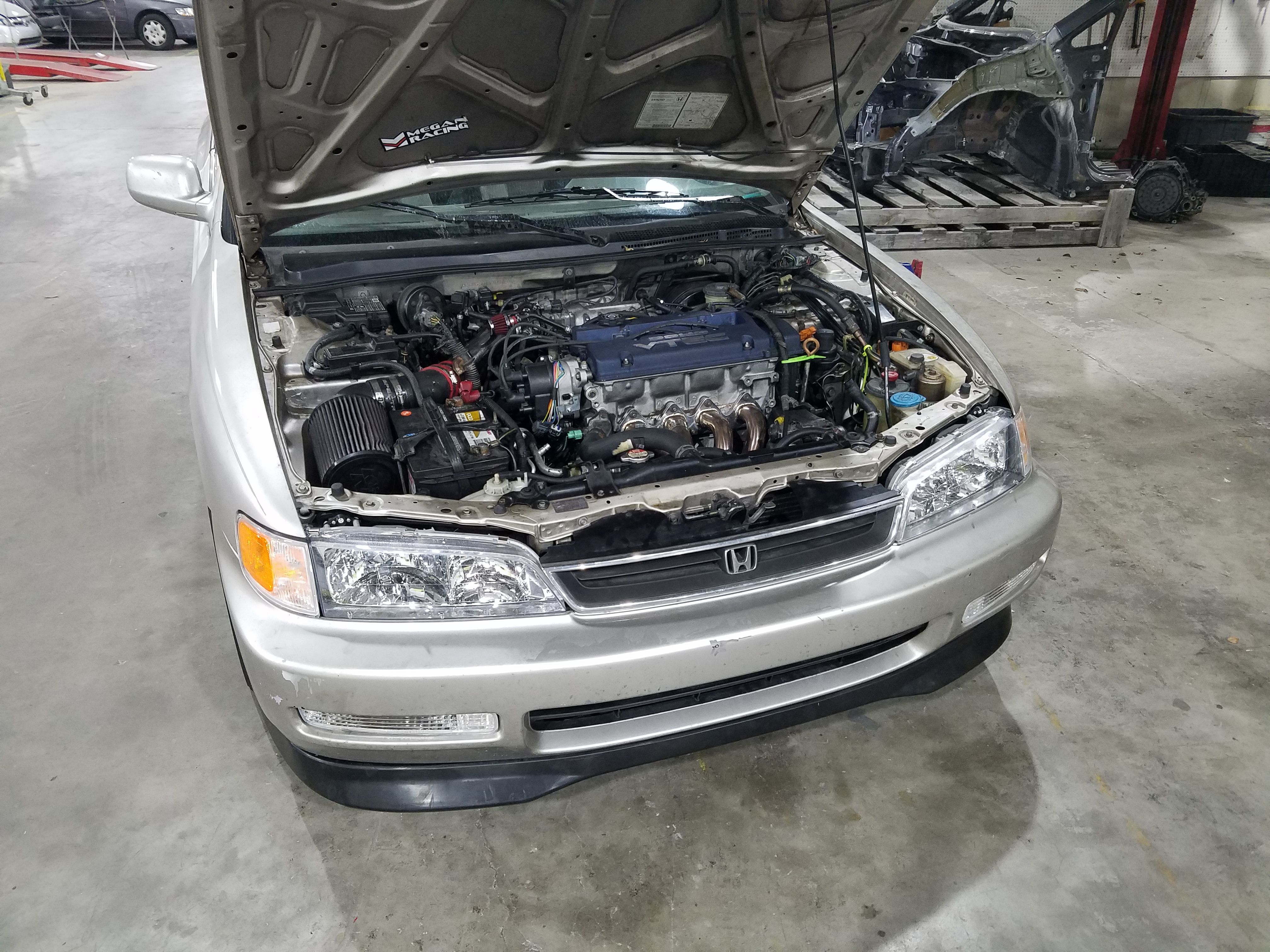

Had to do some routine maintenance and I wanted to note some things that may help someone down the line.
I refreshed my ignition system today. Parts used...
Distributor cap from a 2000 Civic SI
Distributor rotor listed for a 1995 Prelude SI (VTEC)
Spark plug wires and plugs for a H22a
I had nearly forgotten all of the shenanigans I had to come up with to run my H23a swap on an internal coil system (like the JDM model) because the USDM H22 chassis' vehicles all have external coils. If you have the correct dizzy for the internal coil, you just use a 2000 Civic SI dizzy cap and it bolts right up and works perfect.
Hopefully this helps someone.
