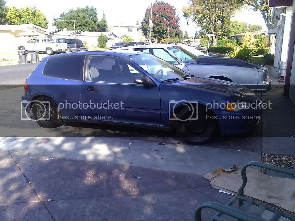

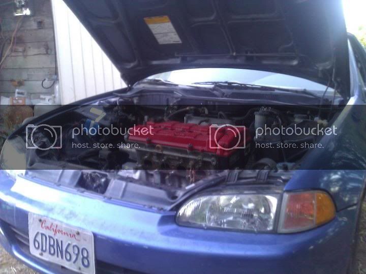

this is my 92 Hatch, i originally got it off a friend for 1700 all stock with 200k miles.
i blew up the d15 not to long ago so i decided to do a swap, i picked up a 95 ls motor and tranny for $650 with150k miles

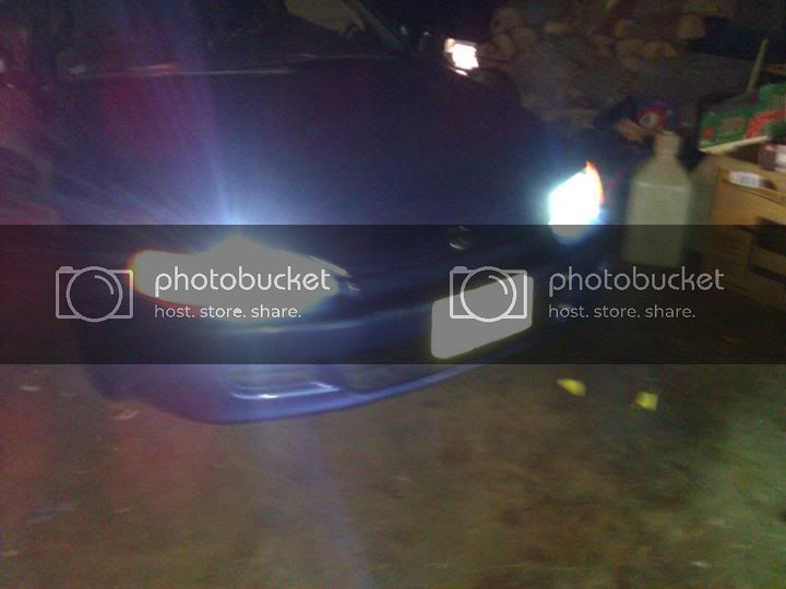

i changed the waterpump and timing belt, and installed a XED stage 3 clutch i got off ebay. this pic was taken right after i dropped it in
it still a work in progress, basicaly im just buying parts here and there that i need for the swap.i just installed the shift linkage and short shifter. i still need to get the ls ECU, axels, dizzy, and wiring harness. im also going to buy all new coolant hoses, an aftermarket alum radiator and a handfull of miss. parts like new spark plugs, spark plug cables, new valve cover gasket , belts, and stuff like that. eventually i want to throw a b16 tranny in it but that will be later on down the road, right now i just want to get it running.
Also does anybody know the official name of the piece that goes in the tranny that the speedo wire plugs into? i need to buy one but cant seem to find it on ebay.
i also need to know if the injectors from my d15 will work in the LS
this is my first honda, it was just my daily but im hoping this swap will make it somewhat quick and fun to drive.

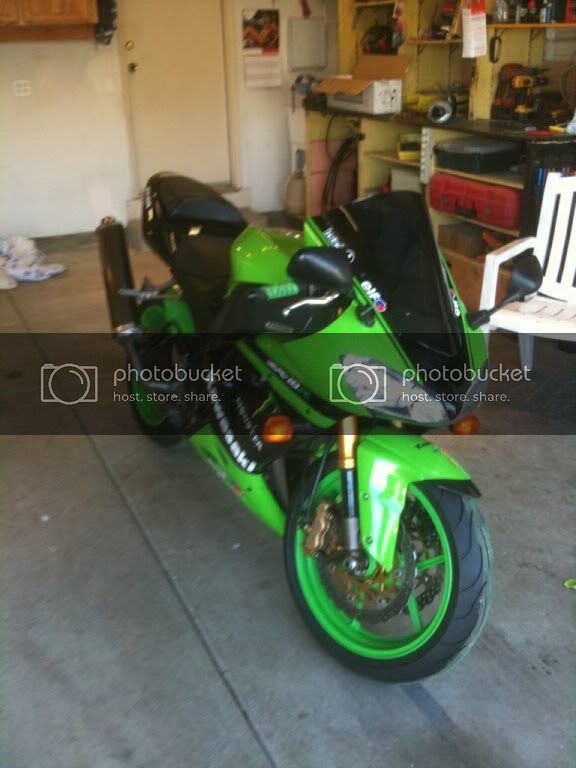

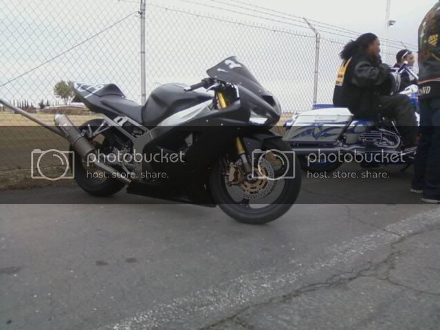

my 2003 zx6r that i built wen i was 16
its lowerd in these pics becouse i was at the drag strip

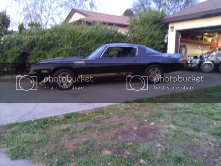

i ended up selling the zx6 when i was 18 so i could build my 79 z28 camaro(wich was my graduation present)
this was wen i first started
and the finished product
i owed my dad some money for something and he wanted my car, so we made a deal and he cleared my debt and gave me his 04 zx10r
well i ended up crashing the zx10 and sold it for 1700, bought the hatch, and here i am!!! haha
yes all injectors are 240cc except for vx,cx,lx,are 190cc if I remeber corectly
if you have a trans that has a cable sticking out of it, it is a cable speed trany vs electronic... You could convert it or go get a 97+ I believe.. you also mite be able to use your D series trans speed sensor if I remember correctly.. its the Speed Sensor
thank you, its definatly the electronic kind, just didnt know what it was called.

i was gonna go for the lightend flywheel but i didnt have the money at the time, im definatly gonna get one when i put in a b16tranny.
^ Just have the machine shop lighten the stock OEM flywheel for you. They can turn metal off the back side of it and balance it. No need to replace flywheel. Use a stock clutch disc, with a stage 1 pressure plate and you're there for low $. Seems like it was ~$30-40 when they did the one on my hatchback.

Also, the technical term for that part is the Vehicle Speed Sensor.

I would also suggest against a b16 tranny on an Ls if you do any commuting/hiway with it on a dialy basis. You'll be chugging around at 4500 rpm most the time at speed and the top speed due to the ls red line is something like 125 with it IIRC.
gsr is abetter choice, gearing wise, if the ls is too long for you.
i dont really do any hwy commmuting, i want a b16 tranny becouse i like the way they feel around town, wich is mostly the type of driving i do
I have a jdm type r trans on my ls, and had one on my previous ls, and used to get and still get around 32 mpg. My commute to work was 40 miles one way, and top speed is at about 130... Plenty fast for a daily... I finally replaced the ls with a b20... At around 195k miles... (she burnt about two quarts a week with that commute... It's not a super car by any standards, but still a pretty fun car. Super short gearing, coupled to a decent clutch with a lightened flywheel= tons of fun on a budget... Thats my experience...
