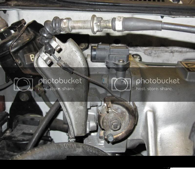

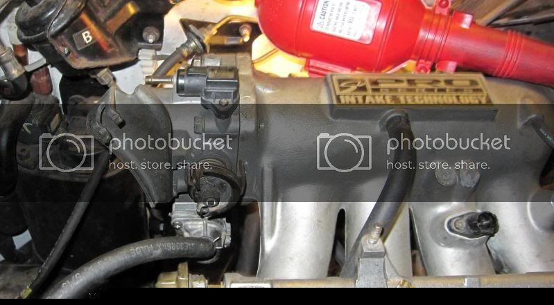

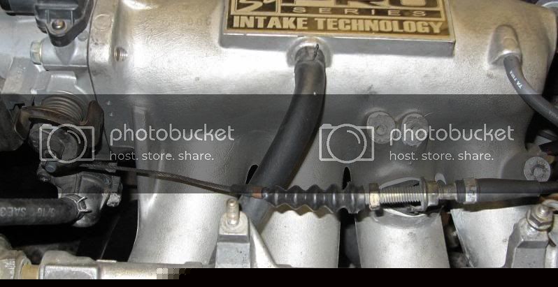

The motor also has a Skunk2 intake manifold on it. From the picture below you can see that there is a throttle cable bracket mounted to the throttle body. Unsure of what to do in order to attach my cable to the throttle body so that it operates properly. Should I use the existing mount? (Pic 2) or should I use the screw holes (pic 3) and fashion my own homemade bracket?
My only concern with this option is how to keep the cable from slipping out of the throttle body if its not coiled around it.

Fixed the throttle cable issue.
I took the throttle rotor (not sure of technical part name) off my old Y8. Then just made my own bracket to hold the throttle cable in place. So now the rotation of it is proper and the cable seats completely in the provided channel.
