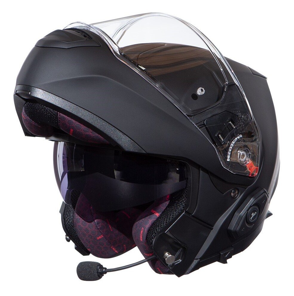

Needs matching trailer and helmet mics with wind screens

For helmets, nah. I've got a good road helmet I like, AGV K1 2015 Christmas Test:
It's nice and visible, more so with the mirrored visor, and the bluetooth headset (Cardo PackTalk Bold) fits the need for intercom/music/phone integration.
(feel free to affiliate link that up and delete this message)
