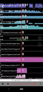

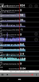

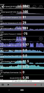

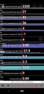

Attached are some images of my Hondash datalogs and engine bay (now has the stock airbox, the hot air intake was installed just for homologation).
