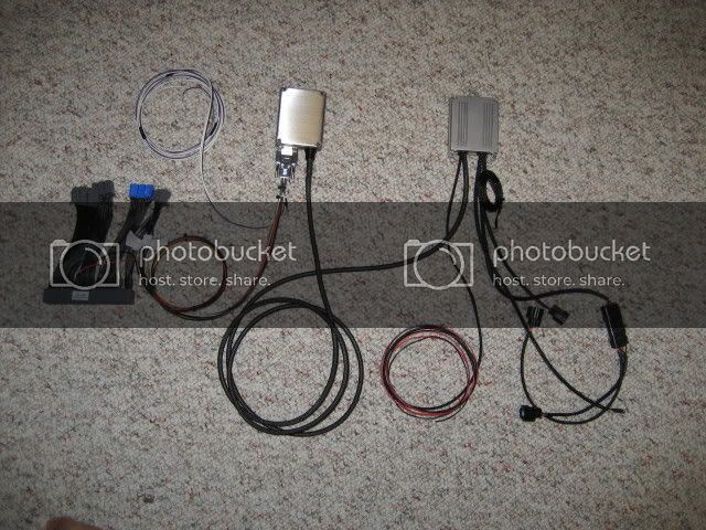

    The Module
    Overview
    The swap module allows for the interfacing of the 6 speed manual transmission with the stock Accord 4 speed automatic transmission computer.

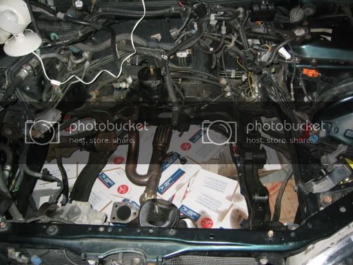

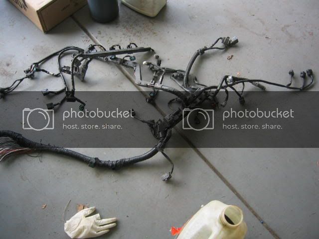

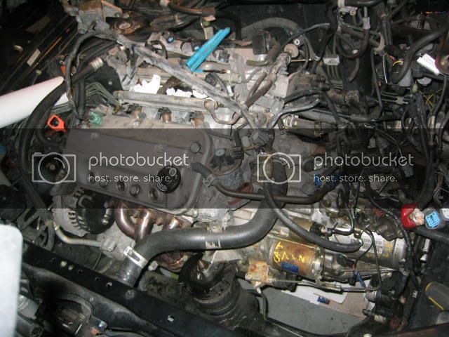

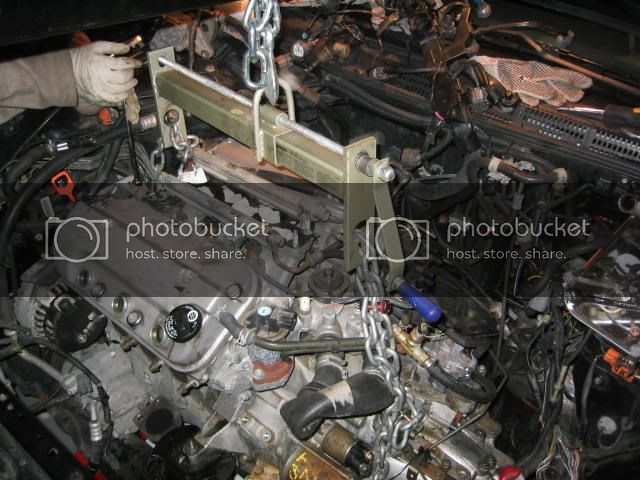

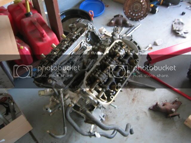

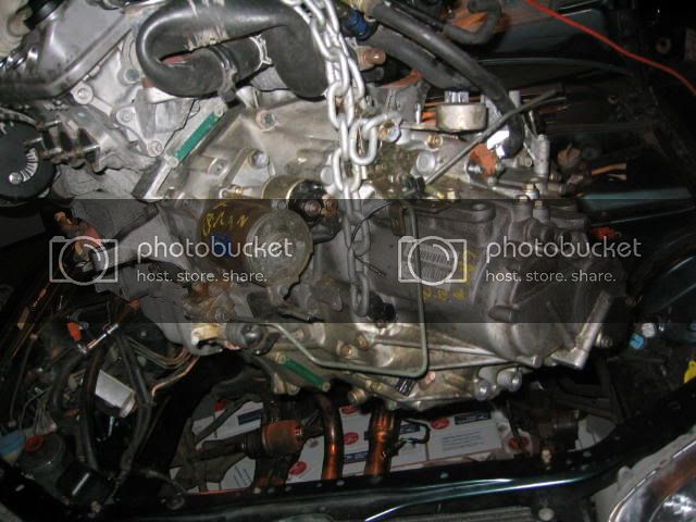

    Hey guys, I am swaping in a 01 J30A1 and 6 speed into my 99 accord, since I bent my valves. This time I am working at home at a much slower pace so I will have time to take pictures and document the process.
    So far I have prepped the new motor and removed the old motor from the car. I am waiting for my new clutch to come in. I will be running a distributor until I can figure out how to get a 01 ecu programmed by Honda.
    As of September of last year I have been experimenting with swaping a 6 speed transmission into a 6th gen accord v6. As of last week I have designed, built and tested all the circuitry that solves all issues that people currently have with swaping in just a 6 speed tranny. Such as running check engine light and transmission fault free, working speedometer, vtec engaging and reverse shift lock out solenoid.
    Several members have contacted me on building modules and harnesses that will allow them to run 6 speed tranny in there 6th gen accord. I was wondering how many people would be interested in this. I am planning on having custom printed circuit boards made and the larger the order the less expensive it will be. I am also thinking about offering a full swap kit with all the parts nesseccery for the swap including tranny. Basically you just pick up a pallet and all parts will be included.
    I just noticed i have the resolution turned down really bad on my camera. The next set of pics will be more clear.

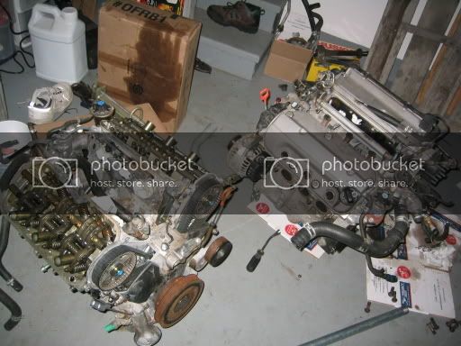

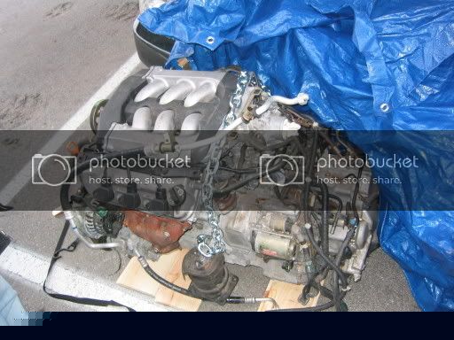

    New motor, well only 28k
    Stripped down to the bone [​IMG]
    Stock harness

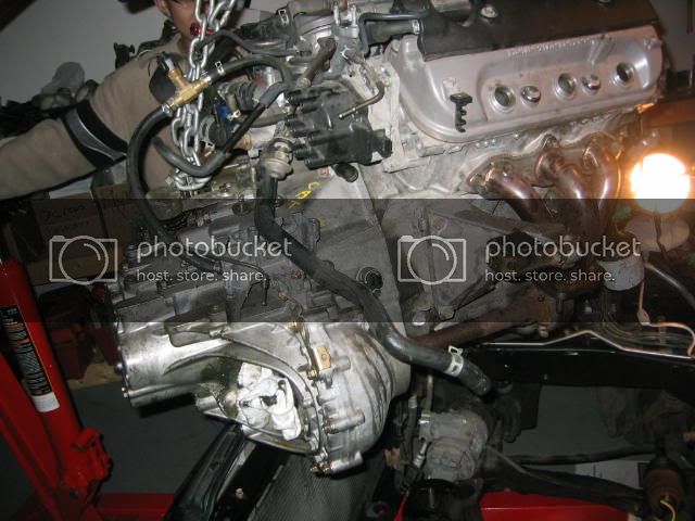

    OOooOOOo J30A1 with 6 speed bolted to it

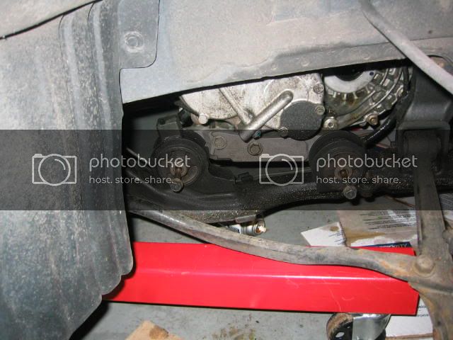

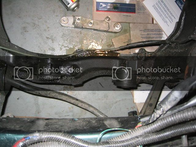

    Tranny mount.
    Hooked up
    Front view
    Rear View
    No engine
    Old engine meet your replacement
    Tranny mount again

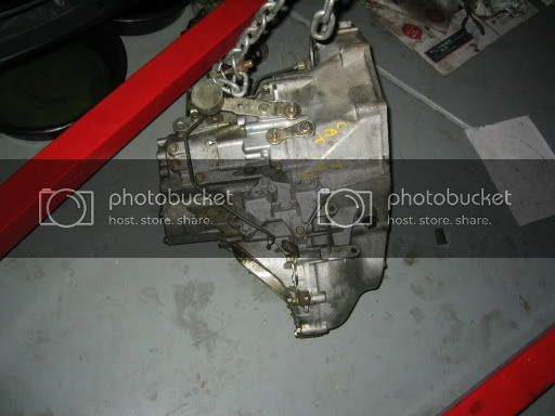

    Unbolted CL-s 6 speed tranny

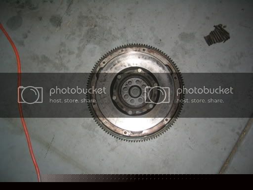

    Flywheel
    any more ? ask me
