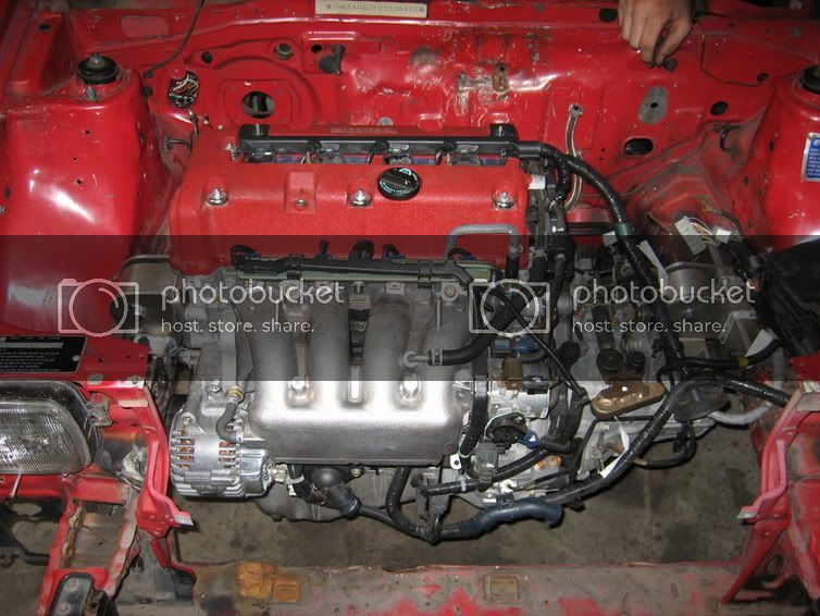

Yeah i've seen a full k20 swap bear minimum is 6k so yeah i know, i just would love to do a N/A k20 in an old school crx. I would still like to go N/A with whatever i end up getting.
I just love the way this looks, i mean come on! But what are some other options besides the k20, that i could do and get some respectable power/torque numbers
