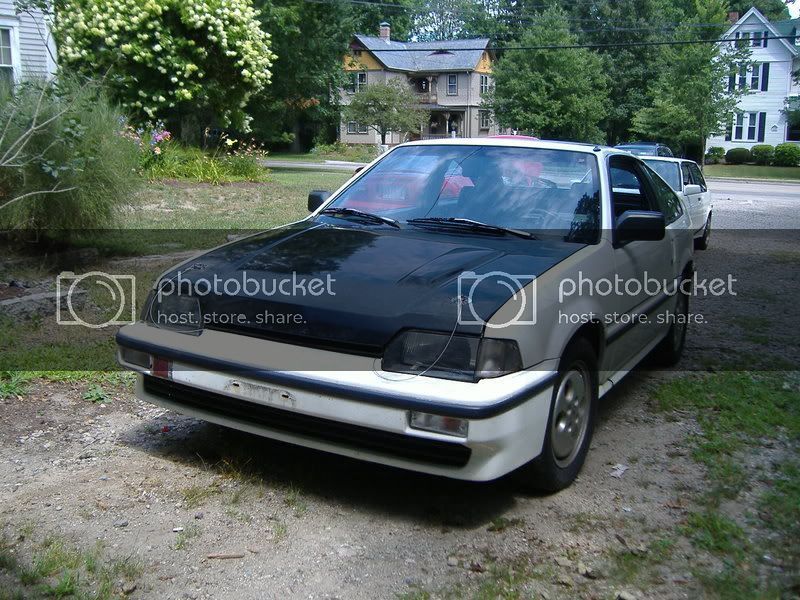

    They're kind of rare and usually expensive...best bet is finding someone on ebay UK or Autrailia (because they speak english) and see if they'll ship them to the US
    This is what they look like (headlights and EDM corners, pic of 1 of my old cars):
    -and I took a pic of them next to the OEM ones (for comparison):
    They use H4 bulbs, so you've got to splice in new pigtails, but you can get them from a 92-95 Civic
