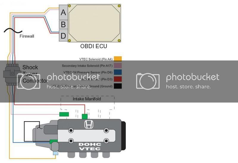

igot a 94 del sol with a 1.5 d series motor hydro tranny i want to put a b16a2 obd1 motor in it what all do i need to make this swap possible??? wiring harness, axles, etc
Baiscally will a b16a2 drop rightin??? how bout the wiring harness??
make sure the engine is obd1 so it plugs and play and you have to get a del sol DOHC Vtec Linkage and p28 ECU or P30 whick are hard to find. And wire up you vtec and your all set
