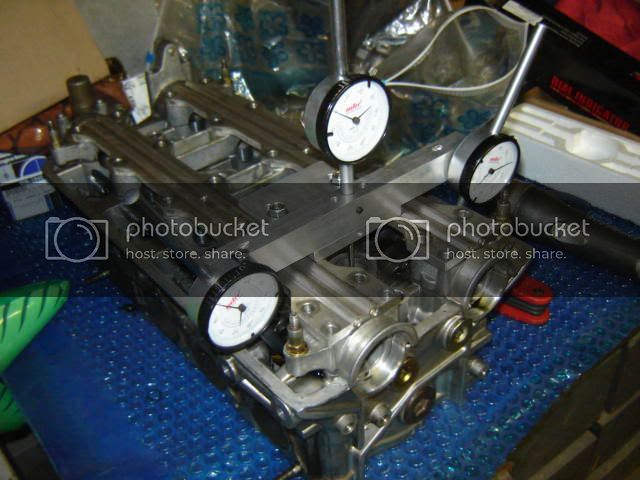

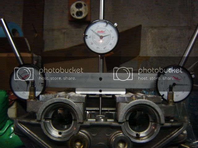

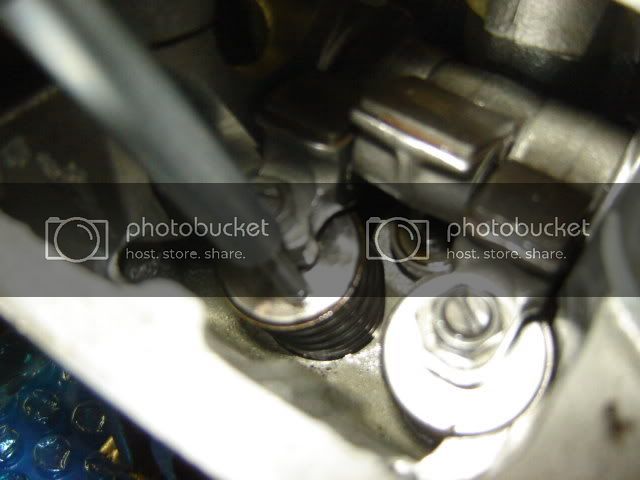

^^^ Yep, claying is becoming a thing of the past. Its just a pain to have to take the motor back apart to check the clay thickness. All of your clearances can be checked with measuring tools while the motor is together. Most people just don't have the correct tools, so claying is their friend. I'll post up a pic of the tools I use to check clearances and degree cams etc. Got the setup from a guy in my area, Mike Belben. Some of you may know him.
Pics of the "clearancing fixture"
Oh you need a link, well sorry there isn't one. I don't know of any write up thats out there to explain how to use it. Not that difficult to figure out though. I may do a write up one day for it, but it takes alot of time which I don't have right now.
My bad, I missed that. But it only talks about degreeing the cams. With the setup I posted up you can get your piston to valve clearance without claying the motor. You can also get the valve to valve clearance also I beleive.
that kit mike belben makes is badass. its a tad expensive, but its the best way to do it. im gonna pick one up once i have the money. theres a link on h-t on checking v-v clearances. i have it bookmarked at home, ill get the link when i get home.
