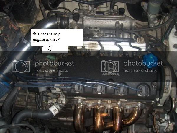

    You have to be quite confused with what motor you have then, if you are telling us that the D16Z6 is non-vtec. How do you figure it is non-vtec? What is the code stamped on the engine? Granted, you may not have a vtec valve cover, which is quite possible, but I'm sure you have a vtec solenoid. Do you know where the solenoid is located? If you don't, it is behind the valve cover, by the distributor...right around there. Heck, take pictures and post them. I have never heard or seen a Z6 non-vtec...but there is always a first for everything.

    There is no such thing as a non-VTEC D16Z6. If it doesn't say VTEC on the valve cover then it's not a Z6. Check the code on the block (it's located to the left of the exhaust manifold right underneath the head) to find out what motor you have...

  10. efhondakid
    7,034
    202
    Mar 2, 2007
    Akron-Canton, Ohio
    Kinda hard to tell from the pic but Im 99% sure that would be yer vtak plug right there yepper. And for the the AT to MT conversion I think you need an aftermarket mount for the tranny
