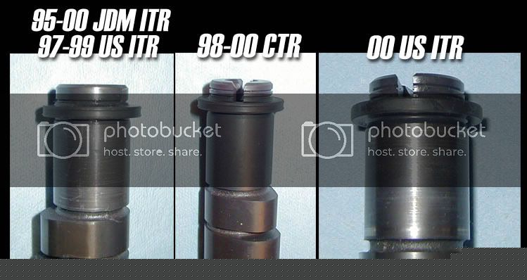

Found some CTR cams....maybe...again lol. Called the number and lady didn't speak English so I was up the creek without a paddle. Left an enail this morning. If thiese ones are real and not GSR cams I get them....I will get some springs and retainers. (guys sell GSR cams for ITR all over craigslist)
Dont be ripped off, use that pic to identify.
I would love to stab them fuckers in the lung with a ice pick and then watch them choke on their own blood while they try to tell their lies.
Thanks bro. Actually I been studying the pics on ffsquad for some time. I have ran into 4 different guys who are selling ITR cams and I get pics only to see they're actually GSR cams (with the three rings on the outer protruding ring) They act shocked and I have even sent them the same picture you sent me along with GSR cam pics. It has pissed me off so bad I started contemplating the 98+spec swap instead. But I came to my senses....$4500+ (with all me for labor) after its in the car and ready to rip finally made me say that it was too silly. So I'm back on the craigslist hunt.
