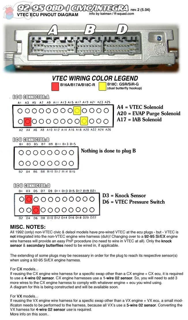

    i just baught a obd1 gsr to put in my 94 integra and have no prob wiring up the v tec but need to no how to wire up the iab selanoid that opens up the secondary flaps in the intake manifold. can anyone help me out. i have obd1 gsr ecu to run it

    Get a gsr ecu or get a skunk 2 gsr manifold and delete the AIB's all together.

    Or if you already have the gsr ecu you need this

    ya i got the gsr ecu and no money to change the manifold right now, not to sure if i have a evap purge selonoid on a 95 gsr. if i do were is it located at on the motor
