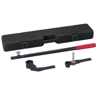

DO NOT LISTEN TO ANY THING ANYONE HAS SAID SO FAR! that is the wrong tool! that is for the 1.6L and up not for the 1.5L d15b7. i would know i have 2 93 civic with d15b7's in both. Honda has a crankpulley holder for the 1.5L d15b7 that cost like $270 and a braker bar that bolts to it for like $50-$70. i went to my local honda dealer and asked one of their mecanics how to remove the crank pulley and they told me about honda's little tool and then they told me to just use a chain strap wrench, a breaker bar of some sort and a pice of a broken or old rubber belt. wrap the rubber belt around the crankpulley and then use the strapwrench(becareful not to mess up your crank pullley or you might end up having to replace it) around the crank. then use a breaker bar of your liking to brace it aginst something so that it will not rotate. i will go back to honda and get the part numbers for the honda 1.5L crankpulley holder and have them up here later today or tomorrow.
correct... thank you for pointing that out
i edited my post above to reflect that that is the incorrect tool
here are a few links to the correct tool for the D15B7
Honda Crankshaft Pulley Holder HEAD ONLY SIR-HO60-2
or this is the same one with the bar
SIR Tools Honda Crankshaft Holder
and here is another that looks like the same company but comes with both types
SIR Tools HO70 Honda / Acura Counter Holder Kit
this one is more money but also comes with both types
OTC4732 Honda/Acura Crankshaft and Harmonic Balancer Holder OTC 4732 OTC Automotive Mechanics Tools
looks to be the same one matco sells for $100 more
Vehicle Service, Drivetrain, Cam/Crankshaft Tools | Matco Tools Online Tool Catalog
