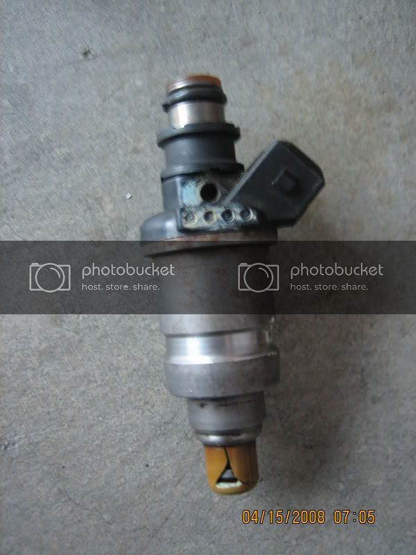

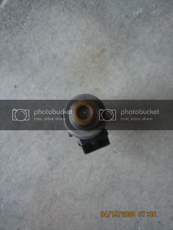

I didn't get a chance to take a look at the second injector from the left, but I took a picture of an injector that seems to be working okay. Is this bad or does it need to be replaced?
I was always taught this... If you drop an injector, you can just throw it out because it will not function properly. You can always test the injector for continuity when it is removed from the car, and sometimes, just sometimes, it will be operative.
