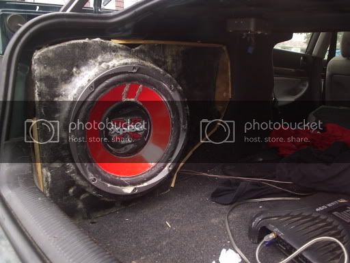

But I guess I could fill you guys in. I got tired of the crappy walmart boxes for the crappy Sony 12's and they take up a shit load of space. So I decided to make a custom enclosure built into the side of trunk area in the Audi. I wanted it to look a little better than just a sub stuffed in a flat piece of carpetted area, so I'm giving it some dimension, thus the rings. I have this ungodly obsession with fiberglass but I'm not over doing it.

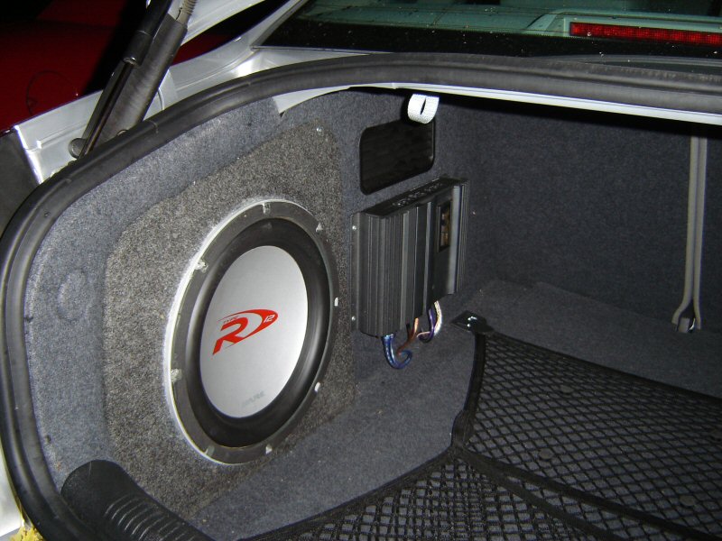

It's going to look more like this one. on both sides.

That $30 B&D jigsaw and $2 bit made life 1000x easier and 10 times quicker.
just to let ya in on how i make fiberglass boxes. if you dont already to this. go to your local fabric store and buy fleece and use that to stretch over your ring and frame. it works awsome and requires very little backfill to make it strong.

Well, it didn't turn out too bad for the first layet. I'm not taking a picture yet because I'd have to bring it upstairs and that shit stinks.
I decided to carpet it it, so it doesn't really matter what it looks like underneath, as long as it has the shape I want, which it does.
You can see more than a few bubbles. Nothing that can't be hidden or fixed.
Almost done, ready to be sealed around the edges and carpetted.
