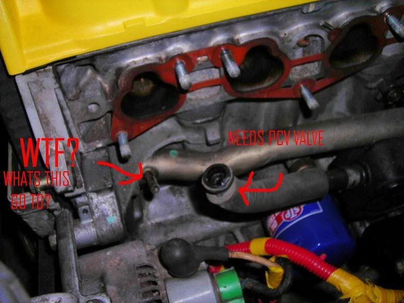

sorry bout the caps...bad habit..anywho, intake mani huh? thanks i wasnt sure..i believe that will work cause i got the skunk2 mani and it just happens to have an extra nipple on top for another hose
yeah man that should be it.beleive me i just went thru that on my b18 an it helped it so much!damn 1500 rpm idle!!!
there is a little hole in the intake manifold in between the runners and that hose goes to that, then a PCV plugs into the hose.. and another hose runs off the top of the PCV to the valve coming off the plenum on the intake manifold
