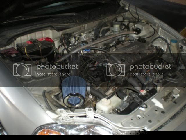

here is a pic of mine:
well I did the swap the motor that you have that is z6 come out of a 1992 civic hatch,you as if it will bolt? It will I know cause it will work everything is the same but their will be a few things that you use on your motor that won't have to be hooked up to the z6 motor the intake manifold are the sme. but you will need the distributor and ecu from the y7 motor but the distributor could be spices together and the colors are the same so just color match them together and off you go the power steering of the y7 motor you will have to use or you don't need power steering because it would still be ok with turning.... well if you need anything else just get at me aand will try to help as much as possible.. I got hte jump plug for the ecu but i didn't need it. The ecu from the z6 get the ecu out tof the 1992 hatch..
