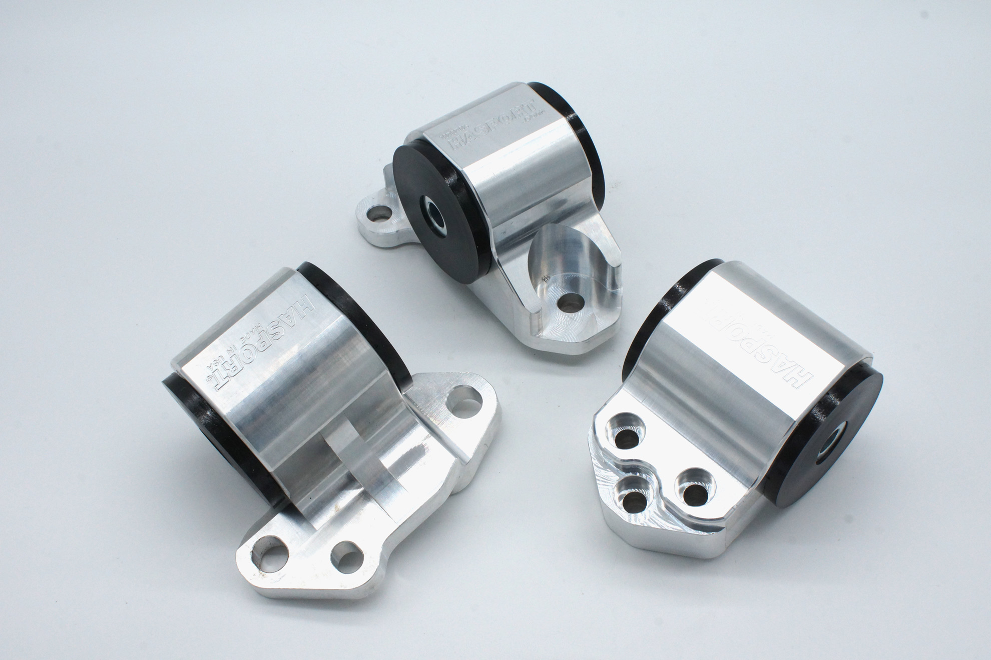

Before many years i changed the engine mounts with the Hasport ones. Now i want to go back to the stock engine mounts and as i don't have the part numbers for a RHD del sol, searching on ebay, amazon, google is a mess. I really can't find mounts stating that will fit my b16a del sol. and the ones i found stating that they fit the doch model indicate that they are for del sols and civics of 1996-over.They are also mostly made in USA and it is a bit confusing whether they can fit a RHD car. Any help will be really appriciated.

i will agree with the 30 year old rubber but, my del sol has a lot of vibration mostly due to the hasport mounts. Del sols tend to have a rattling roof top, and mine is one of them. i feel noices from the roof, doors and even the dashboard. Hasport mounts made things worse for my del sol.
i noticed that the mechanic that installed those back in the day (i did a complete paint to the car with engine removal) removed the lower mounts and even the lower left mount and never installed them. it's been years now and i just noticed, could those 2 be the cause of the, extra vibration?? (i attached a photo showing the missing right lower bracket and mount)
If those mounts are not supposed to cause such problems then i would like to keep them, but i need to fix the vibration issues.
Also another question regarding the hasport mounts, as they are stronger what that means in a case of a crash? will they destroy the chassis?

with the hasport mounts, the helper mounts aren't necessary. The vibration your feeling is the solid rubber with less give. If you want to make it smoother, oem might not be a bad choice. If you go back to oem, you'll want all 5 mounts including the 2 helpers.
I don't think a crash matters much. The chassis itself will take the impact, not the mount unless it's real bad. frankly, if you're pushing the engine and stretching the mount, you're in a bad one and the car is gone anyway.

after your comments on the mounts, i found some more information regarding hasport mounts. people claimed that they called hasport about the vibration and they insisted that you should install the torque mounts to make the vibration less. but now am thinking were they talking about stock torque mounts or after market? 😉

Do you happen to remember what grade the mounts are? 62A is the "street" rating. This is what I have in my RSX. Minimal vibration but still helps with wheel hop. If your mounts have a higher durometer, they probably vibrate a lot.
I've heard good things about the Vibra Technics mounts in terms of the vibrations being very minimal.
i really don't know what grade they are. maybe they have it somewhere written once removed?
