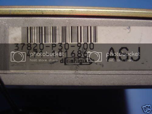

    I'm trying to find out if the ecu posted below is for a manual transmission or automatic transmission. The person that sold it to me on ebay said it's for a manual transmission. I'm thinking it's for an automatic because it gave a code 19 which is automatic transmission related in the haynes manual:mad:

    its actually an auto ecu..the last three digits are 900(meaning its also jdm)

    I knew it when I found out what that code 19 ment. It's a transmission lock-up control solenoid for auto tansmissions. 5 speed ecu's dont even have a code 19 at all:angry::angry::angry::angry:

    you can take one of the resistors out of the ecu..i believe its a52 or something ill look it up

    I agree Auto for sure...but how do you know where its from? 900.....I thought it was a letter where the 9 is....I thought the letter tells you what country it was for? Like A01 vs J01

    the jdm versions do not have the a01 or any of that.. it will say 900 or 901 if its jdm auto
