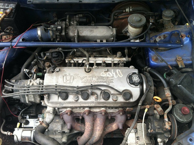

Because she always wanted one. Blame it on the James Bond-esque commercial when they first came out. We got a killer deal on it too, because it needed a wheel bearing. And I was okay with it because I like to autocross and it has this under the hood. (along with some basic suspension upgrades)
F23a1 out of an 01 Accord EX (or so the story goes)
