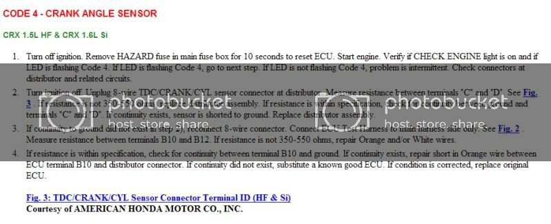

Shouldn't a Code 4 be related to your Distributor cap?
Since the TDC/Crank/Cyl are all inside it.
Here you go if you want to see if the distributor is bad, otherwise you might have to change the pins inside the ECU connector that goes to the Distributor connector.
I can also provide you with the wiring diagram if need be.
