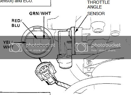

  9. YBLEGAL
    YBLEGAL Regular Member w/ Cheese
    2,759
    36
    Aug 9, 2006
    NW Indiana
    Backprobe the TPS with a paperclip or similar. It HAS to be set right on the money or things don't run right. This is what I grabbed off H-T right quick:
    Testing the TPS sensor:
    Turn the key to ON(II). Set your digital multimeter to measure voltage. At the rear of the TPS connector, break through the insulation of Red/Blu wire with the + probe and the Grn/Wht wire with the - probe. At fully closed throttle, you should measure about 0.5V and, at WOT, you should measure about 4.5V.
