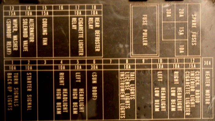

i know this one is from 88-91 Civic/CRX/HB....not sure if it'll help you, but it's worth a try
