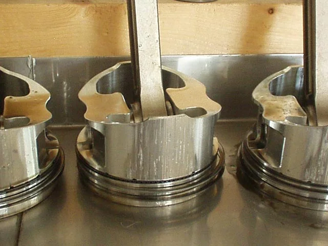

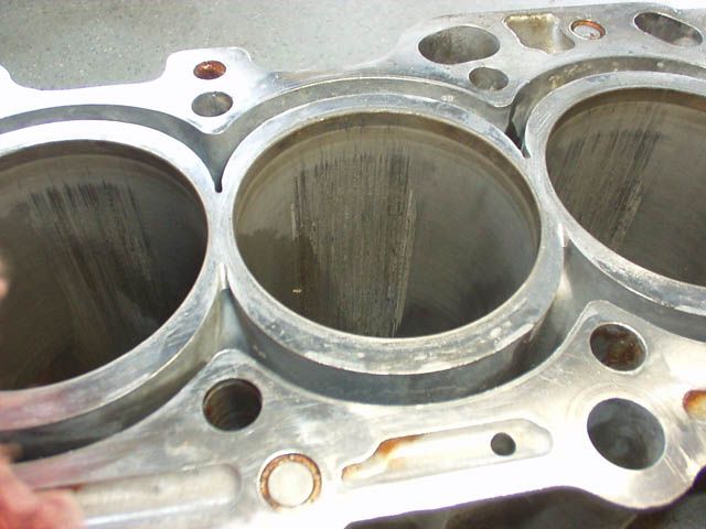

H22 sleeves are a composite made of a material called FRM, or Fibre Reinforced Metal. FRM is an aluminum oxide, ceramic composite material that is injected into the normal iron sleeves. What happens is, the ring/piston will form like a weld to the forged piston when it gets real hot. Over time, your sleeves end up looking like this:
and your pistons,
That said- some folks have run them with no issues. its luck of the draw. If it was my motor, I woudl sleeve it.
