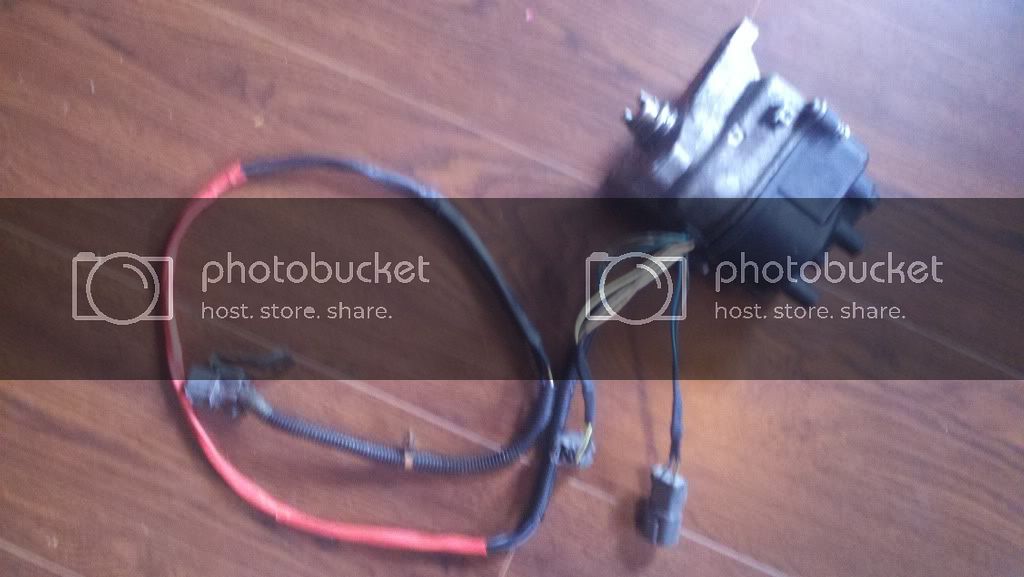

    haha Please don't hate on my Distributor wiring, i ran out of black shrink wrap. this is what i had to do to avoid CEL
    JDM Obd1 convted to OBD2 with a extention to the CKP and TDC connector on the drivers side.
